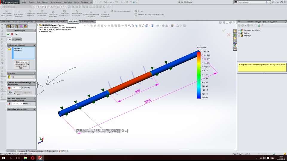

Good day!
I am trying to do thermal analysis and stuck at one spot. The task is pretty simple. There is a tube made of SiO2. Middle part is heated in the middle part with 1100 C in kind of kiln. The rest of the tube is in air, 20 C. So I want to know on which distance from the kiln does the tube have T less than 260 C. I don't know what meaning to write in the gap with convection coefficient W/m^2*K. I've read that Q = h A (Ts - Tf) and I need to know h. but how to define it if I am looking for Ts (wall T) itself? Thanks in advance

heat transfer coefficient is one of the input requirements in SW Thermal analysis, which you should have it either from the literature or manufacturer etc. Otherwise, you need to use Flow Simulation module and you do not need to define such those parameters.

Thank you very much for your answer. I did some experiments in flow simulation but I don't know how to combine them both (thermal and flow). or...how to put in flow simulation that a specific part of tube is radiating heat. Could you give me a small piece of advice how to set it up?

try the tutorial manuals in Flow: The manuals are in the install directory for the documentation which is here on my 2016 install (C:\Program Files\SolidWorks2016\SOLIDWORKS Flow Simulation\lang\english\Docs). Yours might have a solidworks corp directory in the path instead of Solidworks 2016.

Thank you very much. I kind of... misunderstood. I thought to use Flow to find the coefficient. But I totally forgot that it is possible to set up whole experiment there. Thank you)
