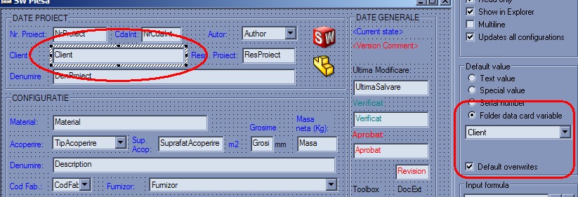

We have standard parts with many configuration. Each configuration inside the part controlled by design table.
When I check in the standard part to vault, new variable mapping to all configuration. So all configuration have same metadata.
1. What is the best method working with many configuration inside EPDM ?
2. Is there a way so variable only mapping to "custom properties" not for "configuartion specific" ?

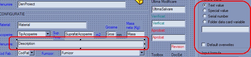

I think your problem is related to the file data card. We use PDWE 2008 and in this version there is no solution to map a variable to "custom.." or "conf specific". In the file data card editor make sure that the variable field have "Update all configurations" unchecked. We have a lot of parts with many configurations (DT) and values for variables are configuration specific and are filled from the file. A common example is the mass of the part.

SF
SF 2009-07-27
There is also an option on card editor : "Default overwrites". For values that are from folder check it (see CF1 image). For values that exists in sw model and are configuration specific "Default overwrites" is unchecked (see CF2 image).
