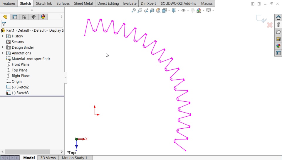

1. Download one of the attached files (SW 2018 format or DWG).
2. The user would open a new sketch on the same plane as the purple sketch:
3. The macro should be accessible from inside the sketch
4. User presses a button to launch the macro

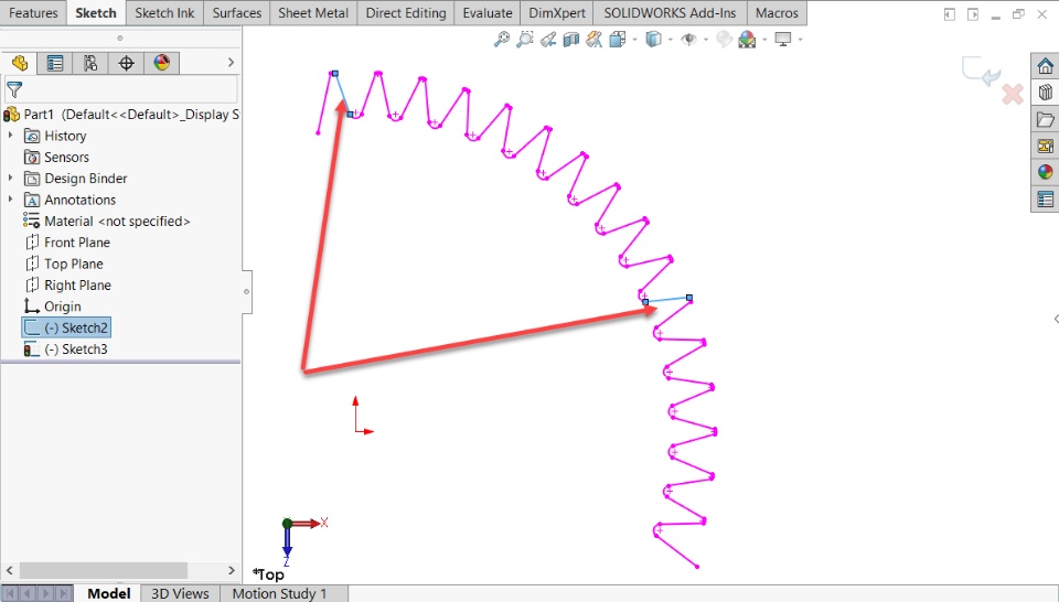

5. The user is prompt to select two lines in the purple sketch (linear objects) to define the beginning and end of a chain of entities (similar to the functionality of the Select Partial Loop for surface edges)

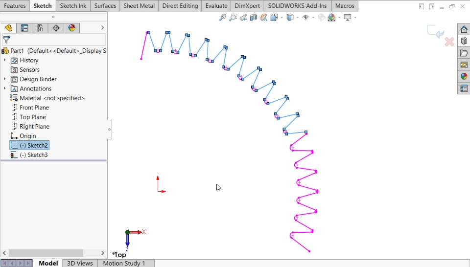

6. The software will select all lines in the loop between the 2 selected lines (not the arcs).

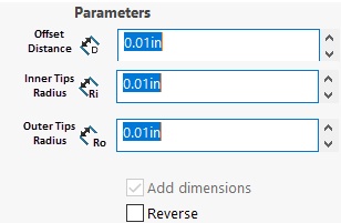

7. The software will prompt the user to input:
  • Offset dimension
  • Fillet Radius for the outer tips (the ones on the far side of the offset direction)
  • Fillet Radius for the inner tips (the ones on the near side of the offset direction)
  • Ideally there should be a nice preview and an option to reverse the offset
8. A property manager would be nice too:

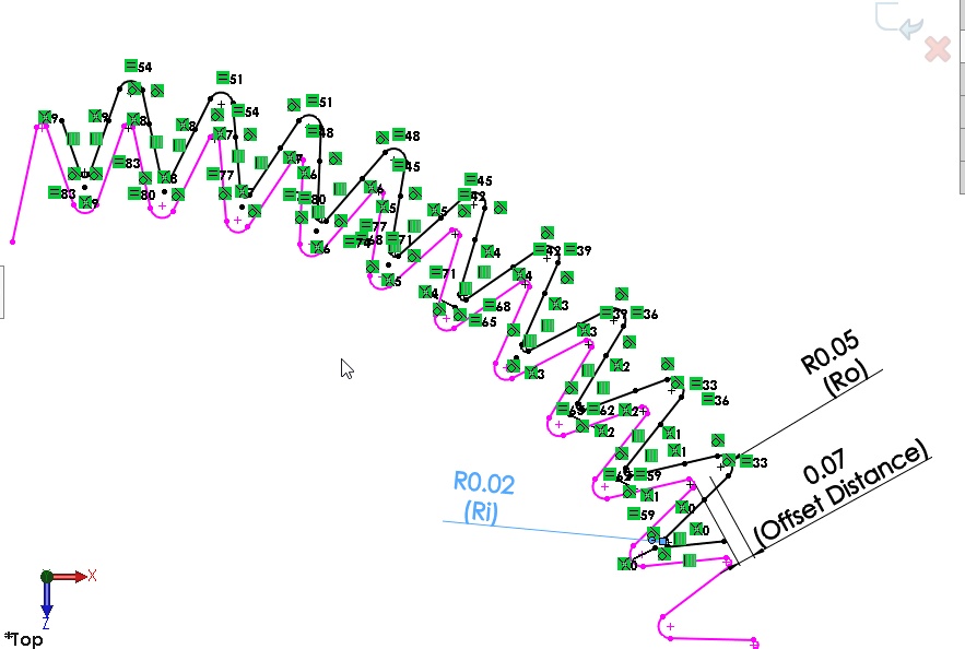

9. The End Result should look like this:
