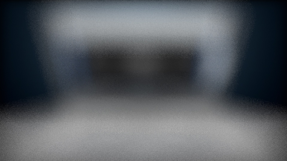

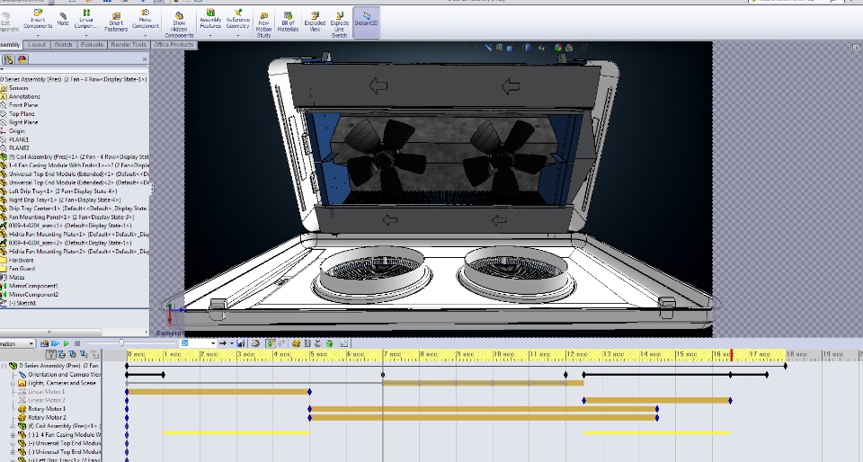

I setup a camera along a spline to go inside one of units our company manufactures. The path starts outside the evaporator, then in the middle of the unit then out again. Along the spline I changed the camera properties to the desired viewpoint. When I save the tga files rendered as Solidworks it looks fine (capture image), however when I change to Photoview rendering (capture 2 image) I get blurry images?
Does anyone know why?

Do you have depth of field enabled on the camera?  That setting would not show up in SW but it would in PV360.
SF
SF 2012-04-17
Thanks Rob, should have thought of that. It's odd though I never ticked the depth of field box before. Is it automatic?
