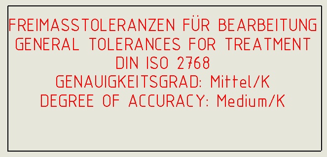

Hello,
I have this block at my drawing in SolidWorks:

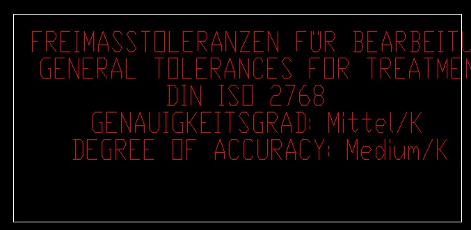

When I do a 'save as dwg', it looks like this in the dwg:
How can I prevent the text of beeing bigger than the frame? Is there a better font to use in SWX? Actually I use ISOCPEUR.

BG 2017-10-18 Best Answer
I have the same or similar issue. when i export flat patterns to DWG I get dimension values that protrude into the dimension lines. I've never cared because they are only reference dimensions so the vendor knows which size material to throw onto the burn table. I use ASME Y14.5M-2009 Font
