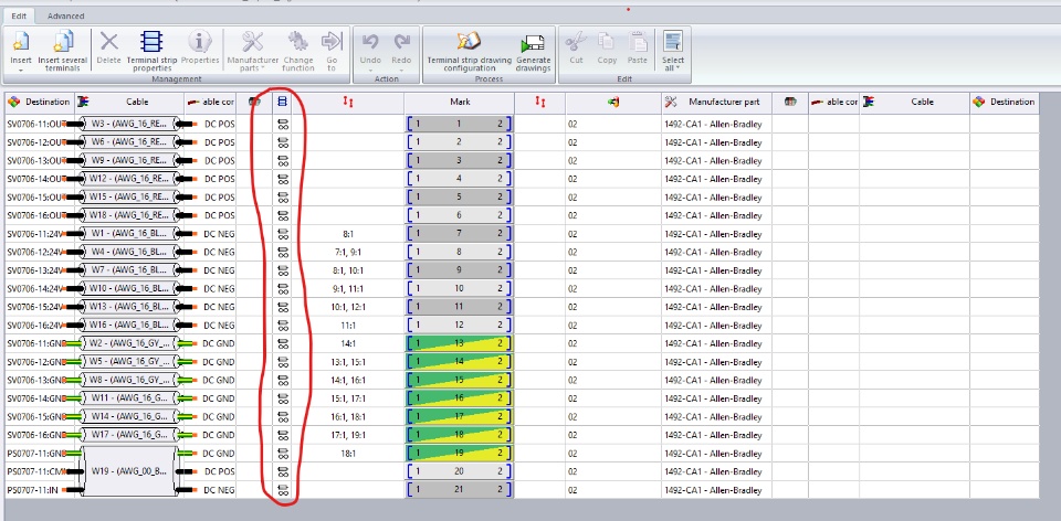

I am having some issues with the terminal strip editor.  All of my terminals are coming in as "Reserve Terminals".  Is there a way to change these to Default Terminals and Earth Terminals as necessary?  What is a reserve terminal?
The drawing is not showing the proper Grounding labels, etc. as I have set up in the drawing config.  All help is appreciated.  see below image.

John, the type of terminal (regular, ground, accessory,etc) is set by the circuit type of the part number, or by the equipotential of the wire/cable attached to it - it looks like you've got Allen Bradley part nums in for your terminals, and your cables are telling the Terminal Strip Manager that those ground circuits should have ground terminals on there.  The software will not change part numbers to DIN-rail-grounded terminals for you, you've got to do that where necessary (and those terminals should have a Ground circuit type rather than Terminal).
I'm guessing you're seeing those terminals as permanent components because you added the parts to the terminal strip before they were represented in a schematic?  That's all that 'infinity' symbol means - those are permanent components that will exist in the project even if you delete the schematic elements that represent them.
Is there something else that's incorrect about the BOM, terminal strip drawing, etc that I'm missing?  I guess I don't really see what the problem is.
