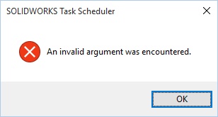

I've been successfully running Solidworks 2015 SP4 on Windows 10 (although I have to run it in Windows 8 compatibility mode because otherwise the open dialog crashes).  If I try to schedule a task in the scheduler, however, this gives an error: An invalid argument was encountered. This happens as-soon-as have browsed and added files in the 'task files and folders' dialog. From that point on, it doesn't matter what I try; I keep getting the error.

I am having a similar issue in task scheduler.  When I try to Print Files, I can add the specific files to print, but when I click on the Advanced or Options button to changed the settings I get the same error (see pic below).  Then after I get the error the first time, I get it whenever I select any other task (such as Export Files, etc...).  I have to close down Task Scheduler and restart it to get the other tasks to start working again.
Although, if I were to reverse the process (by selecting Options first, modifying the options as needed, then selecting the files to print last), it will let me print the files without getting the error.

This is a know issue. Please see the following Solution:
S-068257
What may cause the error message "An invalid argument was encountered" to appear  when performing tasks in the SOLIDWORKS Task Scheduler?
This error is  may be caused by specific user account.
You may advise the customer to log in on the same machine with different user account, and perform a task in the Task Scheduler.
If the error is no longer present, then this issue is related to user account.
The customer needs to contact their IT department.

I just installed 2016 sp5 and 2017 and still have the issue. I had created a new user profile as they suggested. It just took a minute and I didn't lose anything. I kept my old user profile and just use the new one for task scheduler. Not a solution, I know.
My customer was able to resolve it with a reformat and reinstall.

My work around was to built my own vba macro's to do some batch tasks for me (very simple stuff).
