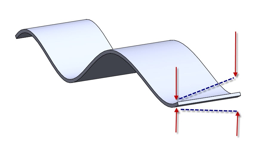

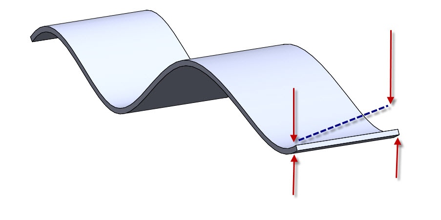

I'm not intimately familiar enough with the flex tool to determine whether or not I can do something with the flex command, but here is what I am trying to do.  Let's say I have the following shape.  I would like to taper shape either symmetrically or asymmetrically.
I am not creating this shape, but am just using it as an example as the geometry I have has a lot of surface features on it.  With that said, I don't have the luxury of starting from scratch and need to deform the existing geometry.
Thanks.

Jamil, there are a ton of features on the faces, so the draft tool will probably laugh at me.  Dennis, I need the shape to be thicker on the one end, not just deflected.
Thank you both for your suggestions.

It is a turbine part that has turbulators all over the surface, so creating new surfaces isn't an option as there are hundreds of the turbulators on the existing surfaces (pressure side and suction side).  Deforming the part is the only way to keep the turbs intact I'm afraid.
This is an x-ray of a turbine blade I found on the web, so if you look at the trailing edge with all of the features, that's what I'm trying to fatten up.
So imagine the ripple that I drew, but with all of these turbulators on it and of course fillets on all the turbs too.
