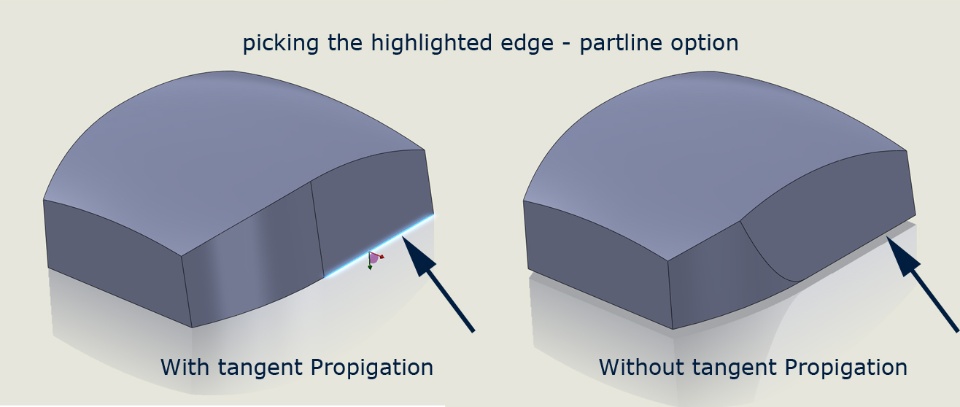

Where in your designs is it important to have and not have(option given to the user) tangent propagation when using the draftfeature?
For instance, when creating a partline option draft, there is anoption to include adjacent edges (faces). Is this something thatshould be on by default, off by default or not an option at all(make tangent propigation off by default.)

You can't draft a face that has tangencies that are not also beingdrafted, unless you allow for some weird brep thing like a tangentface being extended or trimmed such that it is no longer tangentafter the draft.
example, line, arc, line extruded. only line is drafted. arc has todo something funny (trim or extend) over which you have no control,but that's a separate issue.

Matt and Steve,
Please see image I included (updated) in my original post.

Yeah, that image shows the brep weirdness I'm talking about.You should have tangent edges with font to show it more clearly.
In the case you show, the undrafted tangent face is trimmed back,but in other cases it might extend, and you can't control that.Workaround is a ruled surface and cut with surface.
In cases like what you show, I think selecting tangent faces shouldbe the default, but you should be able to override it. You may wantto put more draft on the linear face than the curved one. It mightalso be a design feature instead of a mistake.

Hi Matt,
Actually, there is nothing wrong with the image or solution, it'ssimply doing what it is suppose to do. In the first image,propiagation is on and picking the straight edge, propiagates thedraft to the tangent arced edge. In the image on the left,propigation is turned off and it only drafts that face whileleaving the arced face undrafted.
So this is what I want to hear back from you all; have you usedraft this way to get this kind of solution?
Matt, what I'm hearing you say is NO.

I know the result is what you asked for in both cases, justthat drafting one face next to a tangent face that is not draftedalways results in geometrical weirdness, combined with a level ofrandomness you can't control.
Starting from the first image and applying the same exact draft,how do you control whether you get the second or third image as aresult? It's just a side issue, but one you might consider whileyou're tinkering with stuff.
I don't do this routinely, but I wouldn't want to lose the abilityto do it if I needed to. You never know what is going to come up.If you're looking to assign defaults, I think selecting tangent bydefault would be good. When using the Parting Line type, it wouldbe nice if it also showed the tangent PL edges selected.

How did you accomplish the 3rd image? I get the second image byapplying draft to the linear edge but without Tangent Propiagation.
Not sure what you mean by "show the tangent PL edge selected" Is itnot enough that we show the little yellow directional arrows on thetangent faces automatically when tangent propiagation is on?
I'm with you on both keeping it as an option for those "what if"situations and keeping tangent propiation as the default.

Doesn't your second image show the same result as my lastimage?
Anyway, I forced it to go that way by making a ruled surface fromthe edge, extending the surface and doing a cut. Might have beeneasier to just draw a line on the end of the part and make a cut.
I was just trying to show that both results are valid, but youdon't have any option which one you get.
The little yellow arrows are nice, but ... again I just don't trustautomated stuff in software. I'd like to see the selection spelledout explicitly by showing edges in the Parting Lines list. Thiswould also allow you to do a "propagate to tangent EXCEPT for xxx".Not a huge deal, in the scope of things.
