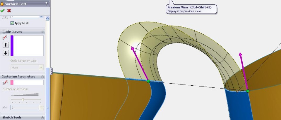

You're going to have to go into more detail. What do you mean"control the number of sections" and spacing? Can you provide ascreenshot (save a .png and attach it)?

Here is an example from the SolidWorks tutorial. (Attachingreally IS slow.)

The "number of sections" that you see (in yellow) are notactually sections. They are just visual lines to help you see howthe surface flows. You cannot control them in the loft tool, but ifyou use the boundary surface tool you can control them with theinformation under "Display" and changing the "mes preview" data.But again, this is just a mesh preview, and they do not control theshape.
If you want to actually have more control to the surface as it goesfrom one to the other you need to create a spline for the surfaceto follow. You can use the same curvature constraints on a spline,and then add points in the middle (the fewer the better). Then youcan move the spline points, as well as control their handles, toget the desired shape you want.
