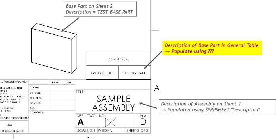

I am trying to create a General Table template that could be linked to the separate model (base model) that was inserted into the 2nd sheet.
For example:
→ The first sheet is an assembly  (Description = SAMPLE ASSEMBLY) and the assembly property is use for the title block (which need to be the same for all sheet)
→ The 2nd sheet is a base part (Description = TEST BASE PART)  that form the assembly and I would like to have a general table that indicate the base part description
→ The general table should be inserted using a template and populate the base part description (TEST BASE PART) automatically when inserted
The document setting is set such that the drawing use Custom Property values from sheet 1 on all sheet in order to make sure the title block are the same for all the sheet (Hence, \$PRPSHEET will not work)
The only syntax that I found to work without affecting the title block is:
\$PRPSMODEL:"Description" \$COMP:"TestBasePart@Drawing View6"
Is there anyway to convert the text in red to a generic syntax that capture the "first" drawing view in the sheet and the model use to create the view? Or is there any other way?
The only workaround that i could think of now is to create a Macro that ask user to: select a view  first and run the macro to generate the table... which i would like to avoid...
