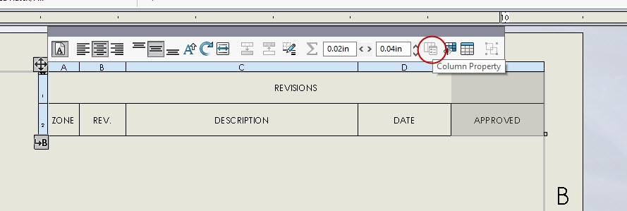

The button is grayed out. We run SW2019sp4.
It is inactive on general table and revision table. Have not tried other tables yet. I need to customize Rev Table and simply cannot choose parameters for columns.
That button is to link a column to custom properties of components. It's for BOMs. General tables and rev tables are not linked to multiple files, therefore there's no reason to have a property column. If you wish to link to a certain property, you can edit the table cell and create a link there.
