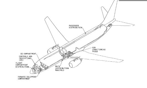

Hi everyone ! Does anybody know cow to create smth similar to this (dont need to show anything else just a particular system)?
You could try placing two drawing view directly on top of each other (One of the system, one of the plane). Use Align Horizontal, then Align Vertical to get them to line up with each other.
Pavel -
I inserted an isometric view outline drawing of our GV that had been done in AutoCad, and then added an isometric view of the O2 system we were adding to the airplane. No alignment, except the ol' "eyeball" method....
