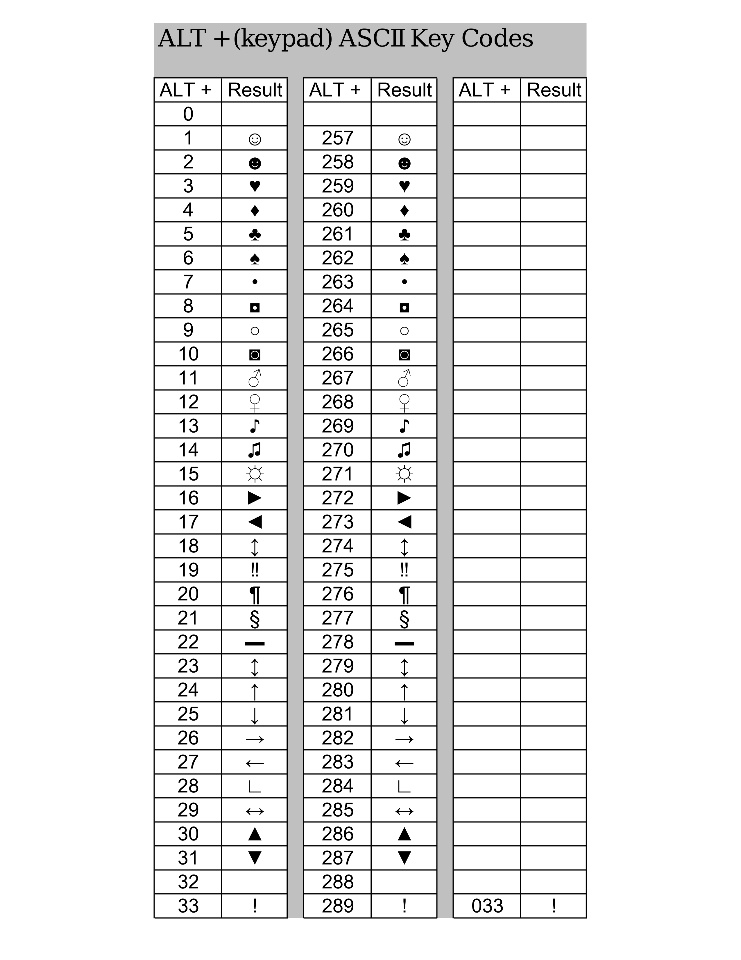

There are about three symbols that I use all the time.  Can I put them in the annotation menu the way I would customize other menus? I am trying to avoid having to use the pull down and search through it all the time.

Scott I am looking to have symbols for text, like a boxed number, plus/minus, degrees etc.
I want to have them in the menu bar so as I type along, I can avoid the pull down.

No it wont, but I use degrees °  (alt 248)  plus/minus ± (alt 241)
The box around the text?  there is a pull down in the Property Manager called Border and that
gives you various types of borders.  But maybe you are already doing that an looking for an easier method.
Other then these I don't know of any easier ways.  Sorry.

I looked for but can't find the list of "alt commands for symbols"

Scott is likely referring to the Windows Character Map.

Yes, I am talking about the character map.
If you just hold down the alt key and press the #'s I gave you you will get those
sysmbols.  The other one I use all the time is Ø (alt 0261).

Here ya go.

If you go to Start>All Programs>Accessories>System tools>Chararcter Map
that will give you all of the symbology you would ever want or need,  You can even
copy and paste from there as well.  Depending on the font will depend on which
character you get per the key stroke.
