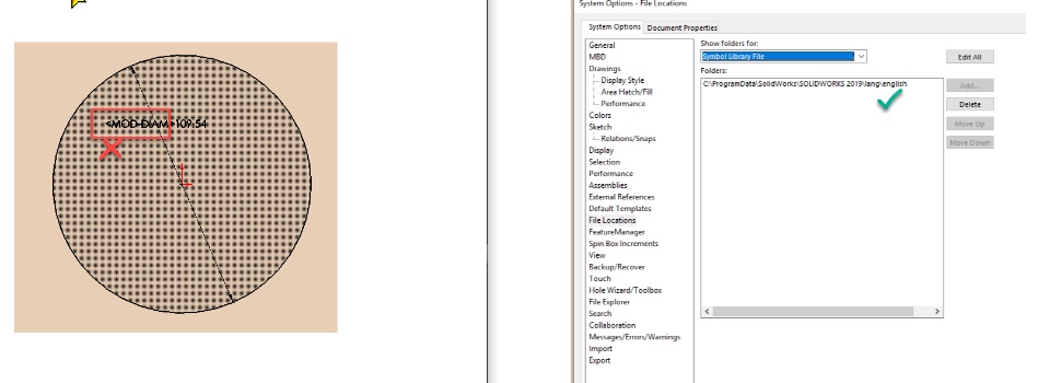

Even though Symbol Library File is okay, diameter symbol in a sketch coming like this. How to fix it?

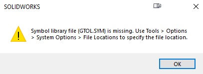

Symbol option in property manger popups following window.

Just because there is a path listed doesn't mean it's correct.  Does a file called gtol.sym exist at the location specified?

Thanks for the help. I deleted the file location then add again, now it is working.

Remove it from the menu, then re-add it.  I've had this happen before.

It is there. It had been working perfectly before. It is today this is an issue.

Check and see if the symbol file is in that folder?  I've seen this in the past and I think that the problem is the symbol file is still in the 2018 folder.  (GTOL.SYM)
