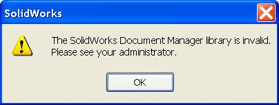

Dear all, I am getting this error trying to use Pack and go from inside solidworks. This is a new install of 2010 on a clean PC installed with no virus software on. Only getting this on my computer, and not on others that have had 2010 installed. All are on SP2.1.
Any help with how I can fix this would be great.

This error message, "The document manager  library is invalid. Please see your PDMWorks administrator.” is caused  by version mismatch of the 'SwDocumentMgr.dll ' file located in  C:\Program Files\CommonFiles\SolidWorks Shared. The Pack and Go  functionality relies on this file.
To fix this issue, rename the  file SwDocumentMgr.dll, and then repair the SolidWorks Explorer  Installation.

sorry, try this:
The error message, "The Document Manager  library is invalid.  Please see your administrator", occurs when  launching SolidWorks Pack and Go.
Repairing the SolidWorks installation via Add  or Remove Programs will resolve the problem.

I had a problem similar to this back in 2007.  I had to register the document manager dll with the OS through the command line.  I think I found and article in the knowledge base on how to do that.
I would definately try Antun's advice first.

Many thanks, fixed via Add/Remove programs and repairing the SWX Explorer module.
