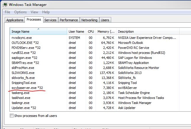

DM 2013-08-22 Best Answer
Glenn,
            I have had this message a few times but it is not consistent on my machine. I have start the Task Manager (I usually right-click in the windows Task bar) and there will be two swvbserver.exe processes running. I select the one that is not running and SolidWorks then continues booting.
I know this is a workaround but it has only happened a few times to me.

GM
GM 2013-08-22
I appreciate that, but in this case, there is only one instance of the task running. (until it dies, of course)
DM
DM 2013-08-22
Glenn,
It just happened to me again and when I opened the Task Manager the was only one swvbaserver running so I Ended the Process and SolidWorks loaded. I guess there doesn’t need to be two of them running. I have attached a picture of the Task Manager.
Dan
