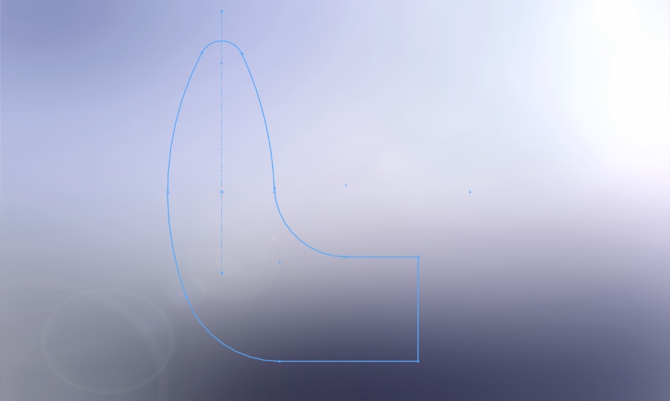

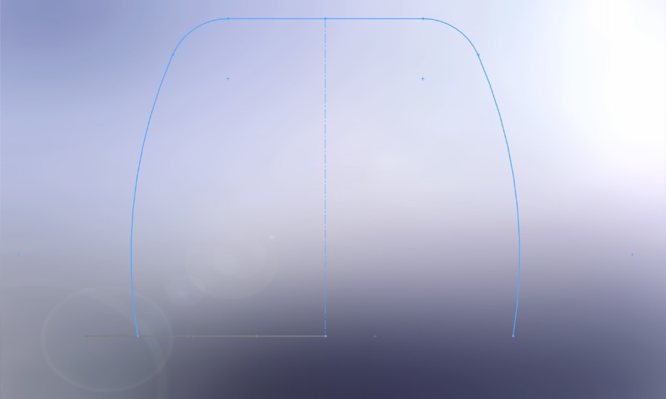

I'm designing a lounge chair that is semi circular and I'm not having any success using the sweep feature. I've tried to use lofts at each part of the path that changes in curvuature but after adding multiple planes at different angles and using the path as a guide curve it still doesn't come out right. I’ve attached some picture to show what I’m talking about. Any ideas how to get this to work?

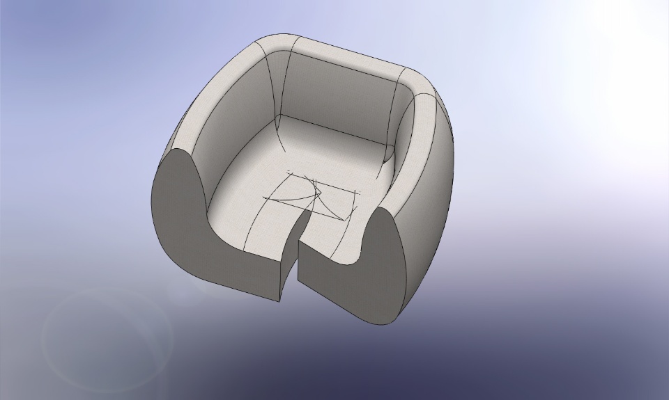

Here is the file. Half of the chair is good enough for me to work with and render for a client but I can't even cut it in half to add to an assembly to mirror and complete. I've tried a standard cut and a cut with surface, nothing works.

You are not going to be able to use sweep to accomplish this because you'll be self-intersecting the sweep profile with the given path. You need to "fudge" your corners a bit and I would recommend doing 1/2 of it as a boundary surface instead with some well defined 2nd direction curves. In order to get the back corner to fill out a bit more you can use Dir1 curve influence option "To Next Curve" and a combination of connectors in the corner to get it just the way you'd like.
