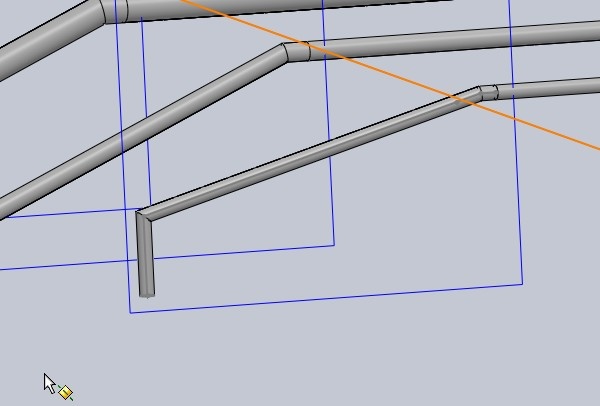

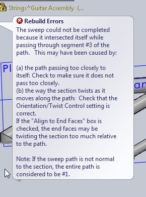

I have attempted to create a swept boss through a simple 3 line sketch I have made with a diameter of .013in. I have been able to create this same boss through the same 3 line sketch with larger diameters. I keep getting an error telling me that I have intersecting lines, decrease the angle of the first two lines, the sweep works. I have attached pictures to illustrate the issue I'm having.

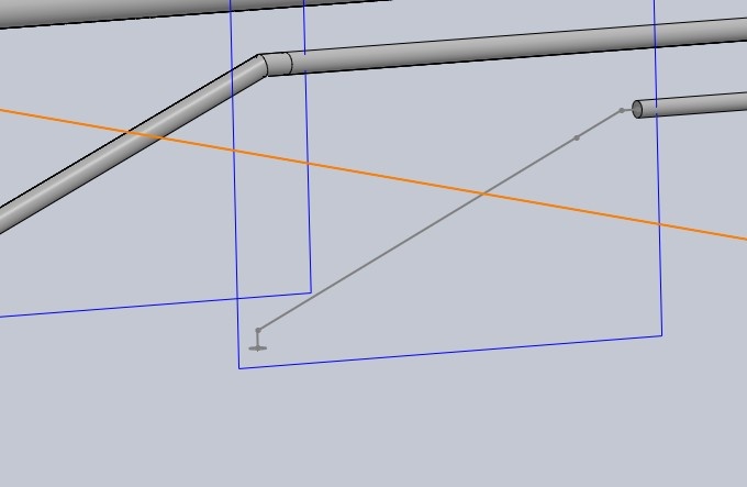

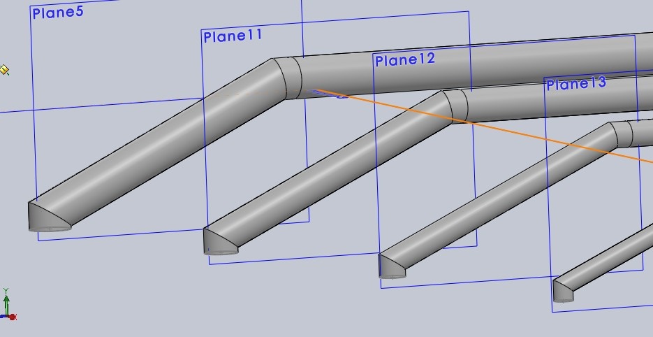

The first picture shows the line I am attempting to sweep. The second shows the sweep I am attempting to make. The third shows the error and the fourth shows the sweep working if I lengthen one of the lines.
I should also state that I have made sure all the lines in the sketch are connected and the last line is made coincident to the center of the circle that will sweep the line. I feel like this will have a very simple solution that I am overlooking, but any and all help is appreciated. Thanks in advance.

Sweeping through sharp corners can be problematic. To make it easier for SWorks to complete the sweep (and also to make more realistic looking guitar strings) I would suggest adding fillets to your sketch.
Maurice
TC
TC 2013-10-03
Also, after adding the fillets use the spline tools and do a fit spline.

Thanks, that made it look much better and it worked!

So I just completely got rid of the fillets and instead just decided to use arcs. But, just to check to see if it was my fault I recreated the lines in another part document and I was able to get it to work using my original design with the corners. I'm not sure why it wasn't working before, but it must have been something I was doing wrong. If it comes up again, I'll pm you with the file. Thanks again.
