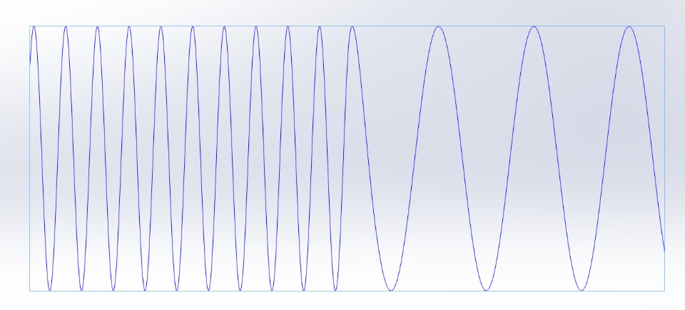

I have a variable pitch helix. It's possible I could have many stages all of different widths.
what I'd like to do is sweep a horizontal line piercing the helix around the helix but the width of the line as it sweeps around should change so it is as wide as the pitch at that point. Effectively I want to get the two extra helixes that are  half a pitch to the left and half a pitch to the right of the point on the current helix and use them as guide curves. Note in this case I've shown constant diameter but I may want to change the diameter at certain points along the helix as well.
Can anybody suggest a clever way to do this?

Welcome to SolidWorks forums Brad.
The sweep option should work fine but I'm not sure as what exactly you mean here
<p><strong>but </strong>the width of the line as it sweeps around should change so it is as wide as the pitch at that point. </p>
You can use guide curves though to control the width of the line (by making the ends points of the lines pierced with those guide curves).
You might also find this post helpful for your future reference.

The problem would be to define a copy of the original helix that is identical to the first but starts 360 degrees further on from the start point. Would you have any idea how to do this? This second helix could be used as  a guide curve but I have had no success in trying to generate it and still keep the original helix free to be used in a feature.
Note a helix can only be used one in a single feature and not shared like a sketch between multiple features.

You can actually make a 3d sketch of the helix by doing convert entities out of the helix and use that 3d sketch as you want.
<p>The problem would be to define a copy of the original helix that is identical to the first but starts 360 degrees further on from the start point.</p>
360 degrees mean the same point or do I'm missing something here.

360 degrees on a helix is obviously not the same point. It is one pitch distance at the same radius along the rotation axis from the start point.

OK got it. Create a plane at the pitch and then draw the circle and using the same specification/value create the new helix. Will this be an issue?

The helix spec is complex so it's a pain to duplicate it but it does work with two helixes. I can't seem to find a way to convert the helix to a sketch. It doesn't work when I select convert to entities.

Start a new 3d sketch. Now select the helix and then click on convert entities.

Got that working. Now the final bit doesn't seem to work. I've
  • Made a variable pitched helix
  • Converted to entities
  • Cloned it into GuideA and GuideB
  • Made a sketch to use as a profile
  • Swepted the sketch on GuideA as the sweep rail
As you can see the ribbon is a constant width and doesn't fill the gaps in the helix. So next step is to add in the guide as you suggested. However when I add guideB in as a guide to control the width SolidWorks fails to solve it. Maybe it's something subtle. I attach the model if you would like to take a peek. Just open the sweep and try to add guideB as a guide and it will fail.
Thanks for the help so far.
Brad

I see both guide A and B as same and they are lying on each other.

That is correct. They should be. The the right hand side of the sweep sketch is bound to A and the left hand is bound to B. It will be a ribbon of changing thickness as it winds around the axis. View from above or the side there will be no gaps and to no overlap.

But why they have same/common start point???

SolidWorks is not going to like "no gaps and no overlaps". You will get the dreaded "Zero Thickness" error, or it just won't generate the body because it knows that it would lead to zero thickness.

is this what you want?

Thanks for the effort but no it's not correct. The sweep profile should always be parallel to the sweep axis. Here you look like you have projected the helix onto a surface of revolution.
To be correct the side profile should look like a series of steps of varying width. The width of each step is the distance from one point on the helix to the next point 360 degrees further on but the steps are flat and parallel to the sweep axis.
