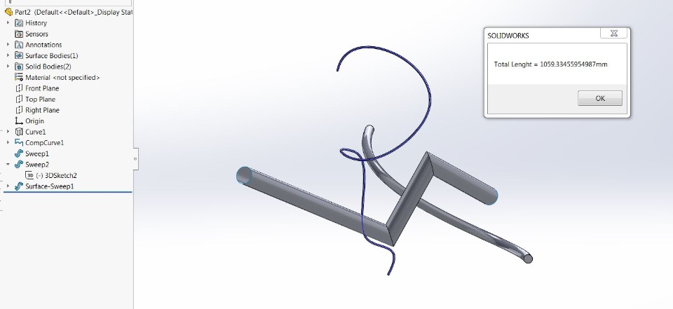

Here I'm pleased to share my super-macro .
I've came across several times, (and not only me, as far as I've seen,) with the need of calculating the total length of 1 or several sweep features, where the path is made of multiple segments, sometimes not easy to select one by one.

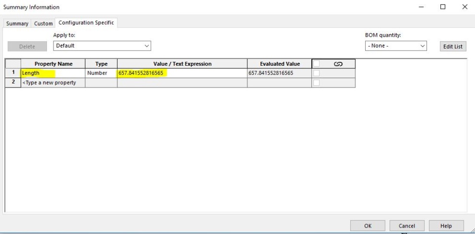

So this macro calculates the total length of all the sweep features within a part, distinguishing between construction and non construction segments.
It could be a wire, tube, pipe, cable, etc....
Once calculated, it returns through a MsgBox:
But also added as a Custom Property "Length" to the current configuration, that can be pulled from a BOM.
08-08-2018: macro updated including Composite Curves and any kind of sweept, solid or surfaces.
Enjoy it!!

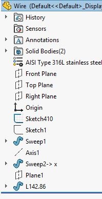

After a full review of this Macro, I found several things that could go wrong, share sketches, suppresed features, modification after the sweep, etc... and to be honest there were too many requirements to meet for this pour macro.

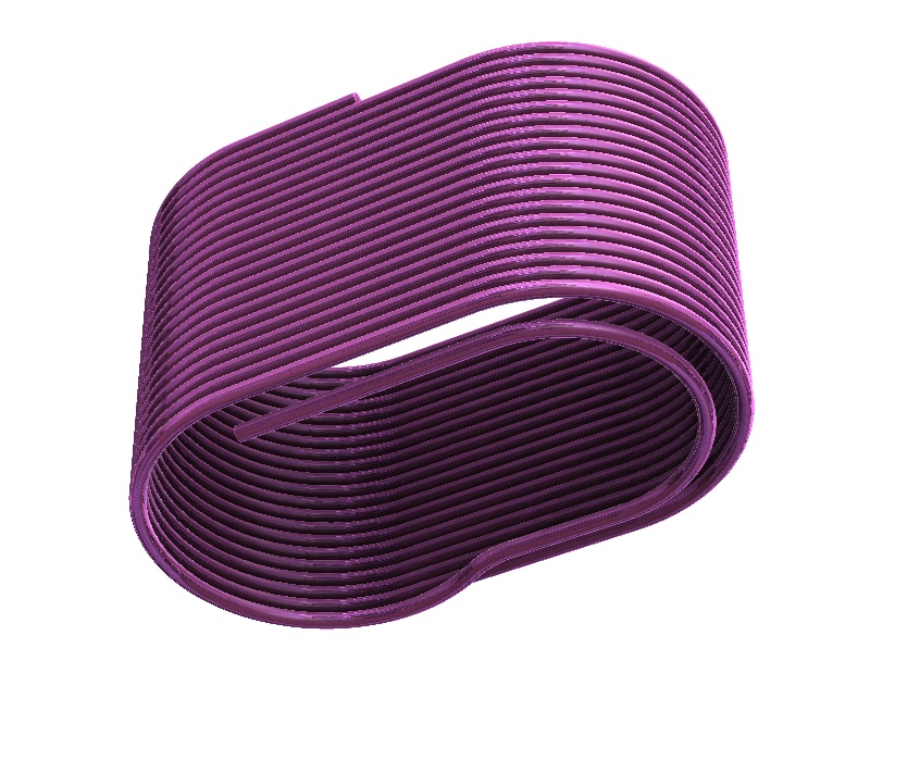

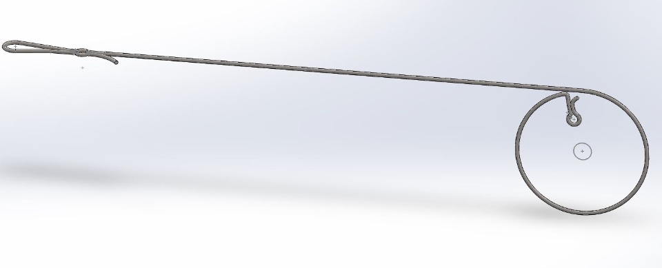

Usign it intensively for calculating fibre optics length, I've got to the conclusion that the process could be simplified a lot based in Volume. So the length is calculated as the Volumen divided by the cross section.
The few restrictions are:
  • the cross section must remain constant,
  • and all lengths must come from solid bodies.
So the tricky part is to determine the cross section. In this case it looks for a sweep features and check its faces, till it determines which one is the cross section (last one).
It can calculate the lentgh of something like this, as long as at least 1 feature had been made with sweep. other could be patterns or extrude.
It works as well if a representative face of the cross section is selected previous running the macro.

SF 2018-08-01 Best Answer
Unfortunately it doesn't work when the path is a comosite curve which in my case it's most of the time.
Here's an example
I receive an error on this line:
Set swSweepPathSk = swSweepFt.GetSpecificFeature2

MF 2018-08-08
Hi Habid,
I've got a moment of inspiration and I've updated the macro.
Could you check it if it works fine now, please, and let me know.
You'll need to download it again.
Cheers.

SF 2018-08-09
Million thanks.
It works perfectly.

I have a little problem. On the BOM where it shows the length, it is in 6 decimal places.
Is there a area in the program where I can change it to 2 decimal places?

I think you can change the  decimal places either in part or drawing environment, from Options->Document properties->Units

You can introduce this line of code by the end of the macro, so you've got 2 decimals, let me know if you don't know how to do it.
TotalLength = Int(TotalLength * 100) / 100
Or you could ask first how many decimals through an input box, dec = inputbox("Decimals?")
TotalLength = Int(TotalLength * 10^dec) / 10^dec
