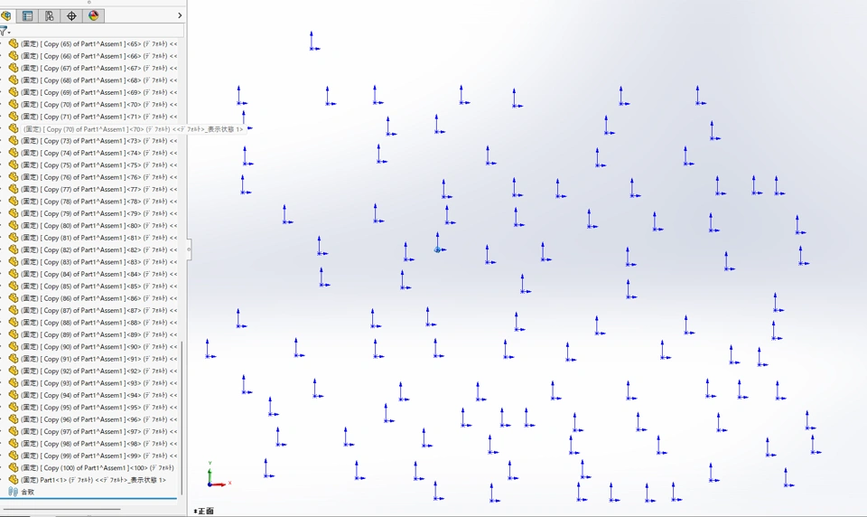

We have a workflow with some template part file that is inserted and edited in context of an assembly to shape it.
I have been able to reproduce it with empty templates.
Create an empty part1.SLDPRT
Create an empty Assem1.SLDASM
From the assy tab insert a component, select part1 and check "Make Virtual", click the PIN mark in the top of the property manager so the command will be repeated.
Click on the screen 100 times.
Copy of Part1^Assem1
Copy (2) of Part1^Assem1
Once Copy (100) of Part1^Assem1 is created is no more possible to insert further virtual components derived from part1.SLDPRT
"Failed to Save" and "Drag and drop failed" comes out.
Inserting the part1.SLDPPRT as normal component first, then trying to virtualize it fails too, but without any kind of error returned
