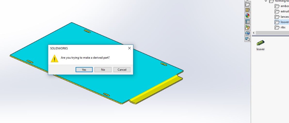

I am trying to form a louver on sheet metal part.
when I drag the louver from a design library, it doesn't highlight target face and upon releasing mouse it asks me if I want derived part ?
If I say no, it open the louver form tool in the seprate window and if I say yes, it adds as derived part in feature tree with mating options to position it.
I tried in Help but it has same steps that I drag and drop on targetted face.
what am I missing here ? Plz, help. Attaching snapshot for the message.

Hi Alpeshkumar,
looks like you need to right click the forming tool folder and assign it as a forming tool folder.

Thank you Bjorn,
Its working now. I appreciate it.
another question. when i tried this feature and export flat DXF, it doesn't show up in it.Is this normal? any suggestion for creating flat patterns?

Hi Alpeshkumar,
forming tools won't flat pattern as it is basically a pressing rather than a bend. The feature will likely be added on a turret punch rather than a press break. The information the fabricator will want is position and orientation. And ideally you'll have specified a forming tool they have.
