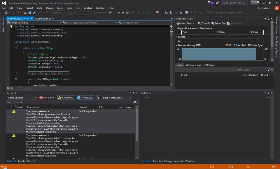

Hi there,
I'm trying to register and run the C# add in from the template.
When I'm running Visual Studio 2015 I get some errors and warnings, see picture.
What could be wrong ?
I've installed the SDK, the zipped file swcharpaddin with the template is on the right location, what else ?
Btw: I'm just a beginner in C#.

Also, regarding my not working C# add in problem, I've studied 'Creating a Solidworks Add-in from scratch' from 'Angelsix', can't get it to work in Visual Studio 2010, I was suggesting it was because of obsolete code and decide to give t a try with Visual Studio 2015...
Thanks for reading, appreciate you help very much, thanks in advance.
