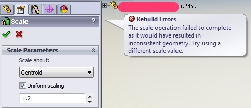

I am using a copy of 2008 server R2 as a workstation for Solidworks.  For the most part, it works fine.  It does not work fine at erradic times; if it isn't working on a feature, it will not work on that feature for that specific part.  It WILL, however, function correctly on a different part.  The features can be done on an XP machine everytime, so the file is not corrupt.
Example 1:  I am designing a mold for "Part A". I add a scale value of 1.2. It gives me an error (I had the message, but I don't have time to dig it up right now).  The part can be scaled on Win7x64 and XPx32 without hitch.  I can perform a scaling on "Part B" and "C" fine... But "Part A" is a no go on my current rig.

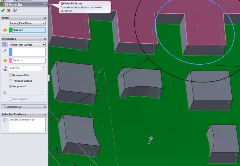

Example 2: I try an "Extruded Cut" (Start condition:surface. End condition: .002 offset from [different] surface).  Similar situation... It works on "Part B" but not "Part C".  It will function on "Part B" on my XP rig without hitch.  The error on my server says something to the effect of "incorrect end condition" or something like that.

****Edited to include "Example 1" crash results screencap****
****Edited to include "Example 2" crash results screencap****

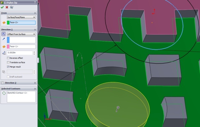

     I included work area to show "before clicking OK" which shows what should be created. I also included "After clicking OK" which shows the fault message also the      abscence of the yellow "preview" surfaces...

I added the "Example 1" error screencap.  I cannot upload a part file here to the forum unfortunately...
My VAR is working on this, too.  2008r2 is an interesting bird because kind of like "it is Win7, but yet it isn't".

I also added the "example 2" screen caps... To be redundant, I originally made the extrude feature on an XP system without hitch (I actually edited an existing feature to recreate the screencaps).
Point of clarification: I noticed in the OP above I stated "extruded cut" feature and now I cite "extruded boss" feature.  The truth is, I've seen both.  I just couldn't track down that exact example, so the pics above are from the "extruded boss"
