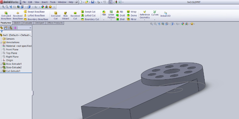

iam having a problem with planes which is i cant create a plane
i have my drawing extruded and now i want to draw on another plane ,
i click on reference geometry then plane and nothing happens ,, the side properties doesnt appear and nothing happens , but when i click on plane , a star (*) appears beside the name in the title bar ,, i tried it from the taskbar and from "insert" and i get the same problem.

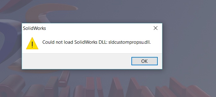

also i get the dll problem when i start the programm

For property Manager: Can you check if it is appearing for any other feature?
For * mark: This is generally indication by SW that part has not been saved after changes have been made.
For DLL file error: Search and make sure this file is present in your system If not then try reinstalling.

Yes it appears ...and everything in the reference geometry works but the plane doesnt

In addition to what Deepak has said about the DLL error - i also found this in the Knowledge base-
Hope that helps

<p>Mohammed Thiabat wrote:</p><p></p><p></p><p>iam having a problem with planes which is i cant create a plane <span class="emoticon_sad emoticon-inline" style="width: 16px; height: 16px;"></span></p><p>i have my drawing extruded and now i want to draw on another plane ,</p><p>i click on reference geometry then plane and nothing happens ,, the side properties doesnt appear and nothing happens </p>
Make sure you have this selected at Tools > Options > System Options:
comment imagecomment image

Then probably .NetFrameWork issue. can you reinstall SOLIDWORKS?

it is selected ,,still doesnt work

Is that file available in your system, I mean that DLL file?
