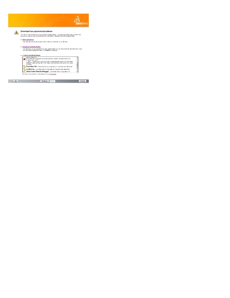

I've been using the SWIM for a while to download my updates but have always had a problem getting the downloads to work. I usually attribute it to high server traffic at the time of a new SP release, however now I am trying to download a SP4 for x32 and I'm getting constant immediate "finishing download operation". Retrys don't work either.
When I try to download manually using the link provided I get 403 server erros, I don't have authorization to view the page when I click on the DL links.
I am downloading the files for distribution from a server location so I am saving the files to a server.
This is extremely frustrating.
I've tried:
  1. downloading location direct to desktop...still fails
  2. turn off download acceleration in SWIM...still fails
  3. asked IT if there are any bandwidth limitations...answer was no
  4. turned off all firewalls on PC's...still fails
  5. upgraded to latest version of SWIM...still fails
  6. using IE and FF (with downthemall download accelerator...worked once awesome about a year ago when I couldn't get SWIM to work but manual did).
Any ideas on what I can try or change to get this working.

The issue on my end....was indeed IT related. We have a gateway (router) that switches between 3 different (external) IP addresses at random. I asked IT to switch me to another gateway with fixed IP to test if this was the problem once I found out and indeed everything worked great. It seems that the SWIM uses some sort of IP validation for providing the links for manual download and for allwoing SWIM to access the downloads. With that all chagned I am back up and running.

  I have been suffering similar problems for years! You may have seen one of my discussions in this forum "The SolidWorks upgrade trap - how is it for you?". As I stated there, my problems have been solved too but in a different way. Some may find this useful - it's another potential stumbling block. Try to persuade your IT department to let you bypass proxy servers altogether. You may meet with some resistance as these seem to be used to safeguard your company from outside attack and to police internet use by internal users. I am now able to bypass the proxy whenever I do a download of any kind.
  My problems were typified by my machine getting to the very end of the downloads (automatic or manual) and then sometimes claiming to have sucessfully completed but always to be told (by SolidWorks IM) that the download was incomplete. On manual downloads, the download manager in IE or FF would zip through the download and then hang for five or ten minutes on the last few MB or at 99% or so. Without the proxy this delay drops somewhat but, more importantly, the download completes sucessfully.

Bryan, have you tried doing the download outside your company firewall?  I had these kinds of problems when I worked for a defense sector company with strict internet access policies and attempted to download the files from my workstation.  I talked to the IT Admin and he set up a box outside the network on a seperate ISP account and we used that to download the installer files, then scanned the laptop and then plugged it back into our network so that we could transfer the files to our server, where I would create the admin image to deploy to the rest of the organization.
