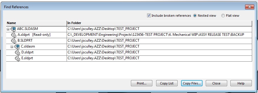

In SolidWorks, File...Find References shows A.sldprt:

I am convinced that EPDM 2016 has one or more fundamental flaws with reference management that were not present in 2015.  I have been using this same set of test files for 4 years with no problems until EPDM 2016.  This is the second odd behavior I have noted.  The first can be found here​.
