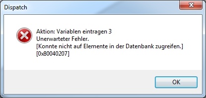

Now we're getting some error messages from dispatch which say (roughly translated from german: "unexpected error. cannot access elements in the database. 0x80040207"
We had some similar messages but quickly found some references to the old server in the client-side windows registry and fixed those.
It seems only this action is causing problems, but it worked for a long time before.
Reading the log shows following entry:

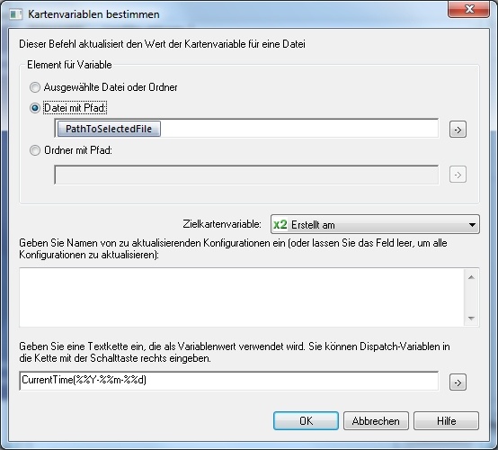

"Error running query in SpDbOdbc
State=22008
Msg=[Microsoft][ODBC SQL Server Driver][SQL Server]Bei der Konvertierung eines nvarchar-Datentyps in einen datetime-Datentyp liegt der Wert außerhalb des gültigen Bereichs."
(translated: value out of bounds while converting nvarchar-type to datetime-type)
Assuming from the log entry it can only be this command, which worked fine until recently:
Deleted and recreated this action already. checked the whole registry (client and server registry) for more references pointing to the old server but couldn't find anything.
Does anyone know a possible solution to this? I assume there to be some more references, or it might be access-rights-violation because of the new windows domain, but we really can't find anything.
