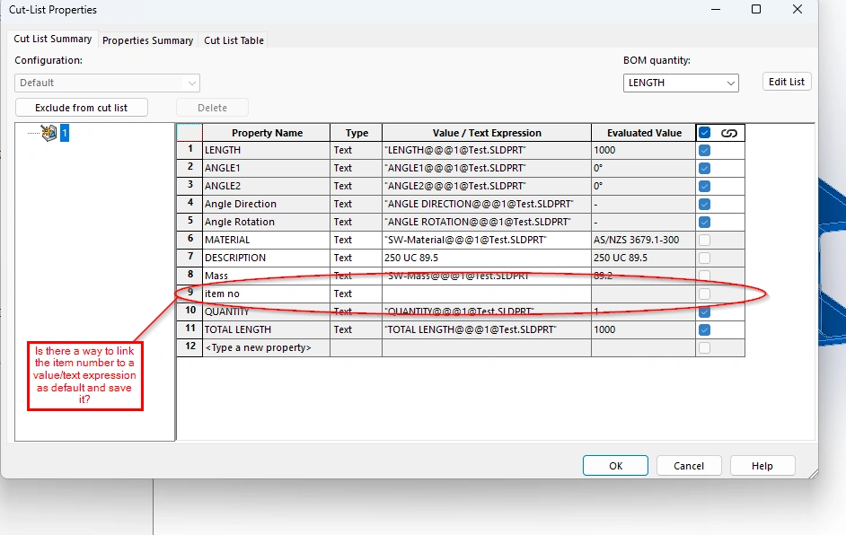

Scenario 1 – Weldment Profile (e.g., 250 UC):
When I create a new weldment using a standard profile like a 250 UC, I notice that most of the cut-list properties are automatically populated with linked values. However, one common issue is that the Item Number field is always blank by default. I usually have to manually go into the Value/Text Expression dropdown and select "Cut List Item Name" to populate it.
Question:
Is there a way to set this link ("Cut List Item Name") as a default value for the Item Number property, so it’s automatically populated for every new cut-list item?

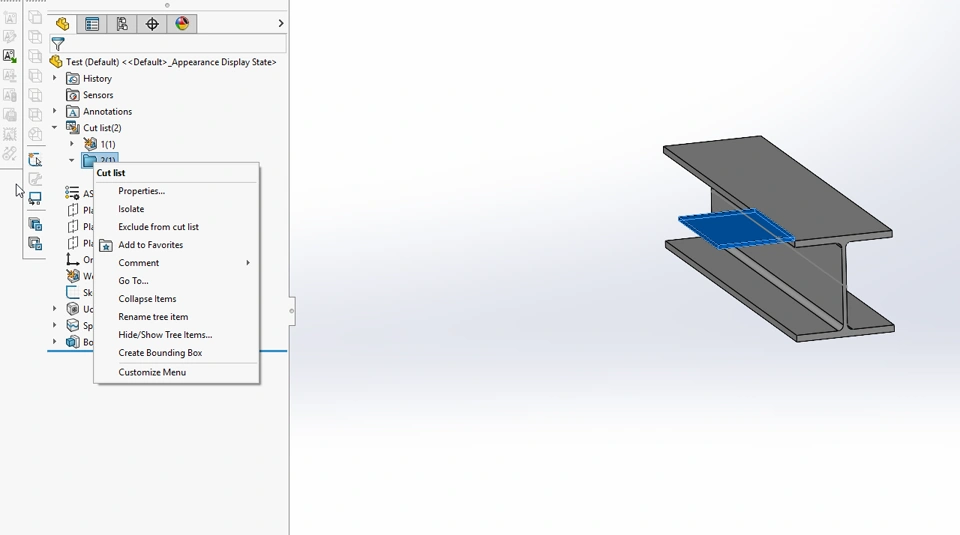

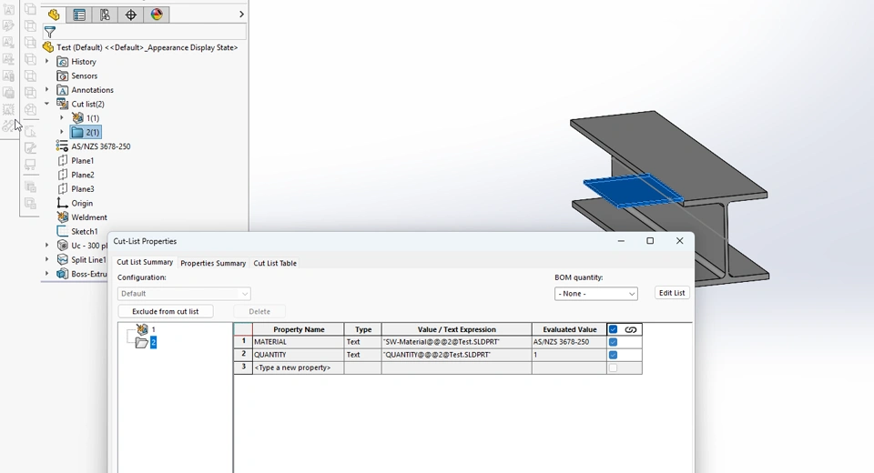

Scenario 2 – Non-Standard Geometry (e.g., Custom Plate):
When I add custom geometry like a plate (not a standard weldment profile), the resulting cut-list is much more limited—it lacks many of the default properties and none are pre-filled or linked.
Question:
Is there a method to add custom properties and link them to default values (like material, thickness, item number, etc.) so that even custom bodies have the same property setup as a standard weldment profile?

  1. Add that as a custom property to your weldment profile sketch file (.sldlfp).  When you do that the custom property will appear as a cut list property when the profile is used in a Structural Member function in a Part.
  2. See this blog post that describes how to create Plate as a weldment instead of an Extrude.  Combined with the information above in #1 that should solve your issue.
