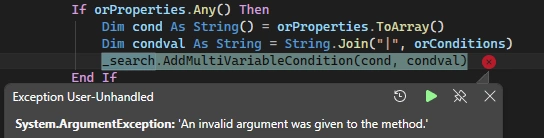

I think your attempt at this post is broken. The reason it is broken is that it lacks this sentence, the purpose of which is to explain the brokenness.
Additionally, I'm pretty sure "condval" is not a valid argument because there are no spaces before or after the pipe. So it's going to look like
Condition1|Condition2|Condition3
All the examples in the help show that conditions are separated by space-pipe-space, not just pipe.

I see, so it needs to be "a | b" instad of "a|b" ?
