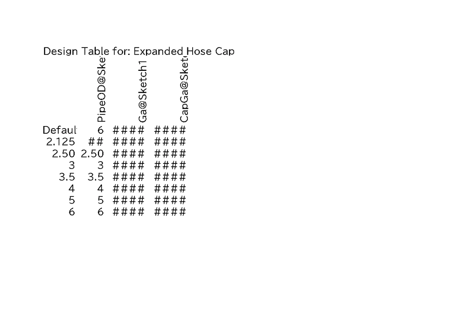

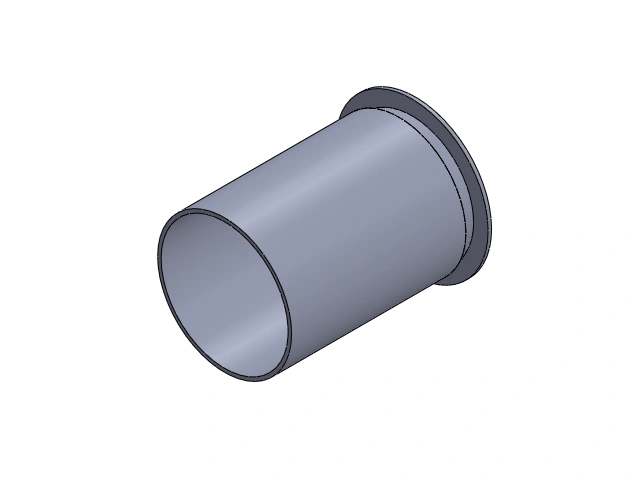

Attached slddrw, sldasm, design table. The part is not updating the drawing views to show the correct reference configuration when i change the reference configuration of drawing view 1. the second drawing view is set to use the parent drawing view, which is drawing view 1 so they should update simultaneously but they do not.
How should I fix this?
