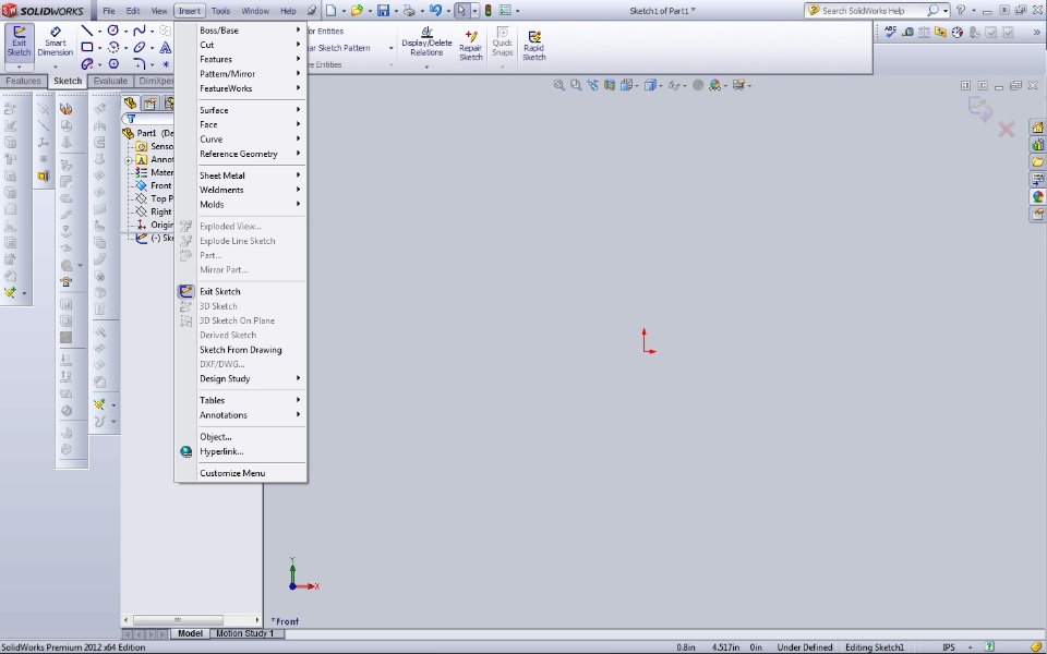

I have just "upgraded" to SW 2012 SP2 and am seeing two problems right off the bat:
1. Insert->Picture does not seem to work while in a sketch (or otherwise). There is simply no option to insert a picture under my Insert menu whether I'm in an active sketch or otherwise.
2. If I insert a picture using Tools->Sketch Tools->Sketch Picture, then I only see the first page of the Sketch Picture PropertyManager. Tools->Add-Ins->Autotrace has been checked under both "Active Add-ins" and "Start Up", and I have even rebooted the computer in case that was causing it not to register the add-in properly. Nothing works to show the second page of the Sketch Picture PropertyManager with the Autotrace functionality.
Any help would be greatly appreciated! I'm familiar with these functions as I have used them repeatedly in SW 2010 without issue.

That's what I was attempting - to insert the picture in a sketch and Autotrace it. Then I also realized that Insert->Picture doesn't exist under the Insert menu.

From a couple of "Solutions" listed in the Knowledge Base at the Customer Portal;
<p><span class="AppletStyle1">The 'Insert picture' command that was found under the 'Insert' pull down has been moved to the DisplayManager in SolidWorks 2011. For more information, please search for 'Scenes' in the SolidWorks 2011 Help File.</span></p>
<span class="AppletStyle1">Generally, the Insert >Picture option is greyed out if the picture is already inserted in the background.<br><br>Sometimes this confusion is caused because of the inserted picture is not visible in the graphics area. This can happen in two cases:<br>1. If the ‘Picture’ option is unselected under SolidWorks View Menu (View >Display >Picture)<br>2. If "Use document scene background" is set under Tools >Options >System Options >Colors). Change this to Plain, Gradient, or Image file<br><br>Delete an already inserted picture from View >Modify >Picture >Delete. Once this picture is deleted, the Insert >picture option will be selectable (not greyed out).</span>
Which completely flies in the face of the Help file at
http://help.solidworks.com/2010/English/solidworks/sldworks/legacyhelp/sldworks/impexp/inserting_tiff_files.htm
