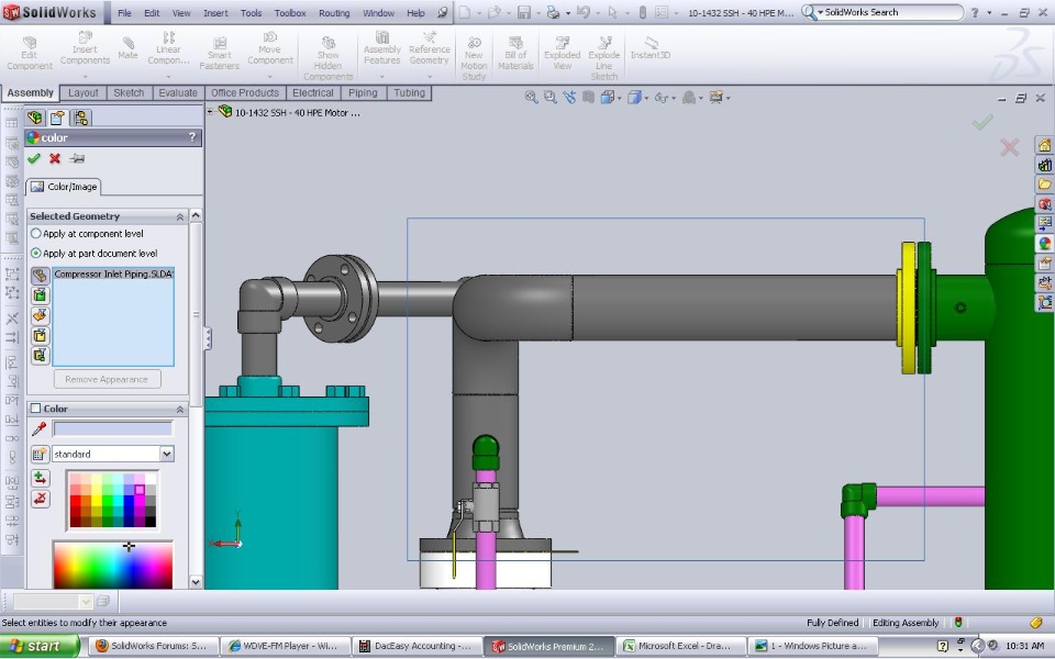

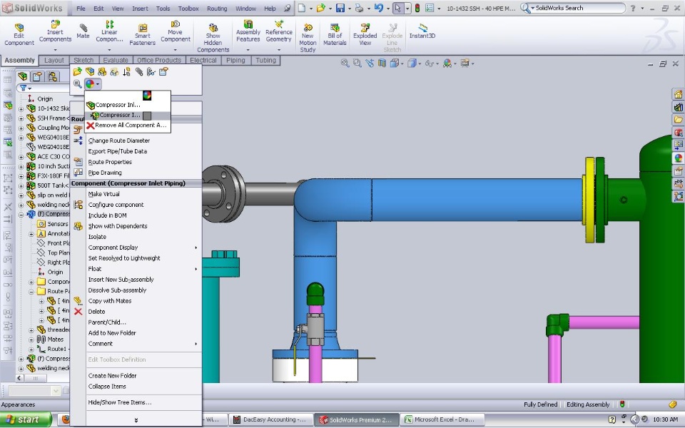

I'm trying to remove an appearance but it won't let me.  I have a subassembly that I added an appearance to within the assembly and I can't remove it now.  The first image shows where they are technically locating the appearance for the piping subassembly. In the second image you can see that remove appearance is greyed out.  Anybody have any suggestions?

try expanding the FM to show the appearance stuff (click on the chevron thingy on the top right of the FM), click in the beach ball column for the component in question and you should get an option to remove appearnce.

For some reason it doesn't show that there is an appearance for this subassembly, even though there definitely is.

Yes I did and there really isn't any appearances.  But if you'll notice in Picture 1 in my first message the appearance does not seem to be on the top level (see how its the second one down).  But when I open up this subassembly there isn't any appearance to it.  So I am a little confused where/how it is placing this appearance.

click on your part in question, choose edit part. while the part is in edit mode try remove appearance then.
DF
DF 2010-07-21
Wow, I can't believe it was that simple.  I guess I'd never added an appearance while editing.  Thanks for the help!
