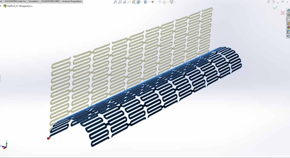

I am currently using the Surface Flatten feature to 'unwrap' various cylindrical surfaces.

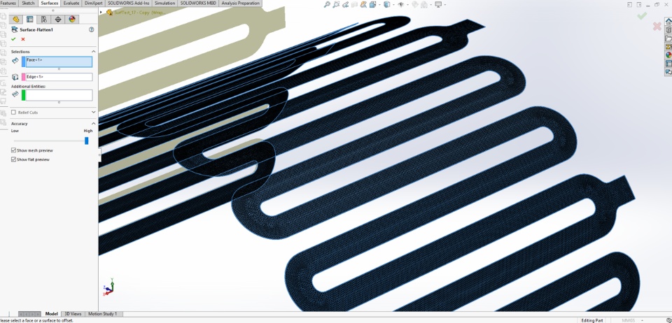

SW controls the number of elements used to execute the cylindrical -> planar transformation during the operation via the "accuracy slider". Higher accuracy = more elements added to the surface.

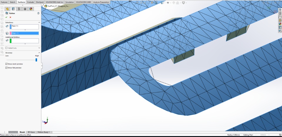

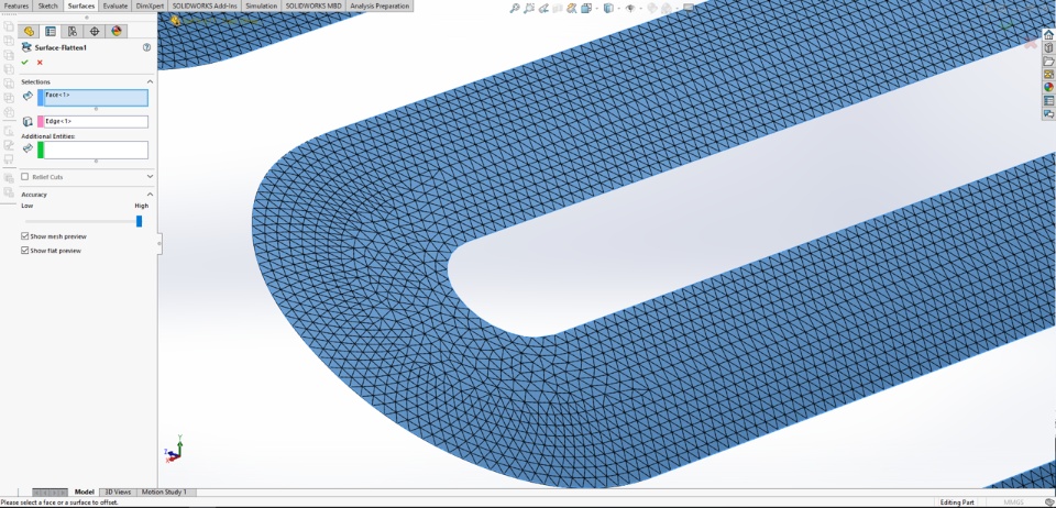

Unfortunately, the surface models I am working with are sufficiently large with tight features such that I lose the desired accuracy as the model (surface) size increases. (note that for some models, reducing to a generic 'repeating unit' is not possible due to its uniqueness).
So, I would like to know if is possible to increase the accuracy of the surface flatten procedure beyond what is possible with the accuracy slider? (i.e. somehow modify the SW defaults).

Image 1: Small model w/ Highest Accuracy (Result: good resolution)
Image 2: Small model w/ Highest Accuracy - Closeup view of automated mesh
Image 3: Large model w/ Highest Accuracy (Result: lost accuracy)
Image 4: Large model w/ Highest Accuracy - Closeup. Note overly triangulated inner radius.
