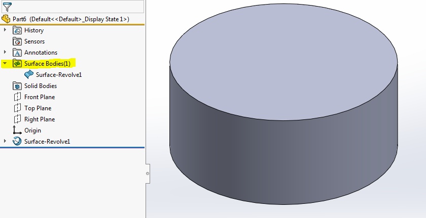

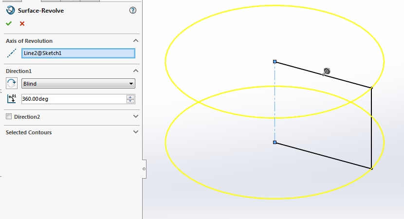

Surface Extrude with Cap Ends creates a Solid / Surface Revolve Does Not
Hi Guys
I'm just wondering if I'm missing anything?  Does anyone else have a need for this?
I often want to make a 'surface box' but haven't a nice way in a single feature.
For Revolves it works great, not so for extrude
I know a work-a-round but it's PITA
Hopefully someone has a better solution but if not I would consider it a useful enhancement request to have an extra checkbox in the property manager akin to knit surface.
In my mind Surface Extrude should always create a surface.  Why duplicate the behaviour of Boss-Extrude?

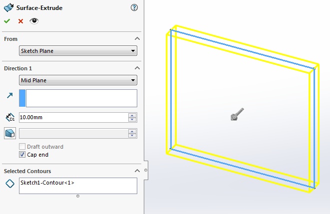

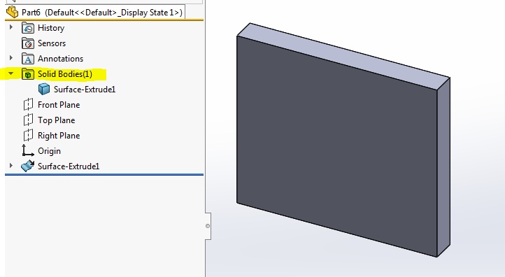

DP 2018-05-21 Best Answer
Interesting.  At first I could not replicate it......until I used midplane.
If you use anything other than midplane it works like it should.   If I use midplane, then it creates a solid.
DP
DP 2018-05-21
But with midplane:
In fact, if you take your extrude and change it to blind....it will switch to a surface box.

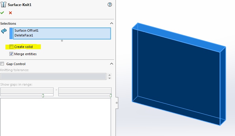

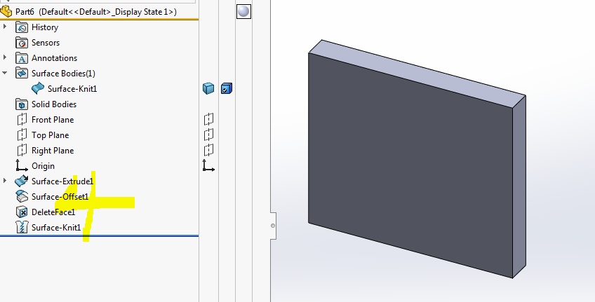

DP
DP 2018-05-21
Create the solid box, offset surface 0mm, then delete the 1 face you used for offset, I guess.
Or make the opened box, then create the lid separately using the same sketch you used to create the box.
Bit of a workaround though.
comment imagecomment image
