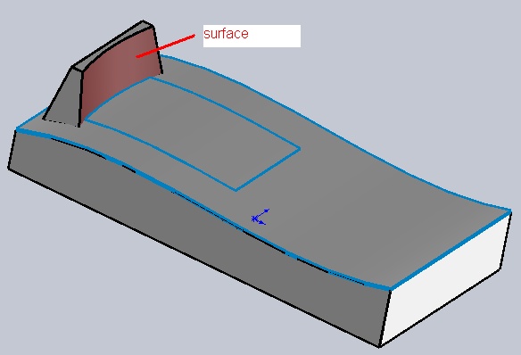

We got a problem to programmtically extend a surface. The following is our manual process.

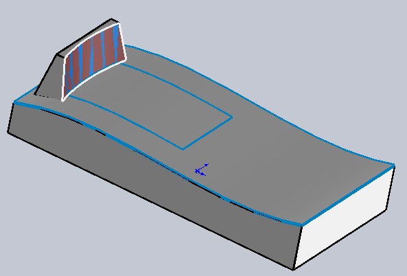

step 1: Select the surface
step 2: Make a zero offset
step 3: Extend the offset
step 4: Make an offset of the extended surface
The corresponding code recorded in MACRO recorder is as follows:

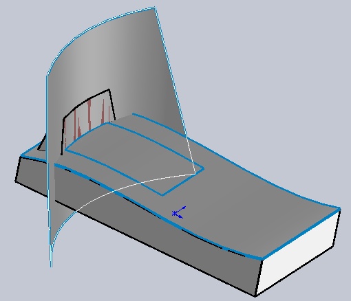

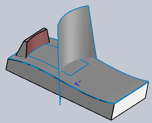

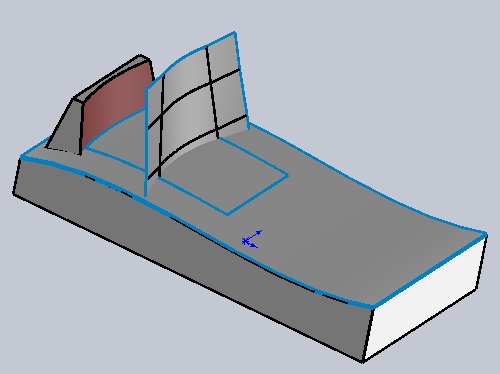

We follow these steps and develop the steps using C#. Finally we got this.
The created surface has 9 pieces and these are gaps between several pieces, which cause a lot of problem in subsequent operations. Does anyone have any idea about this?
