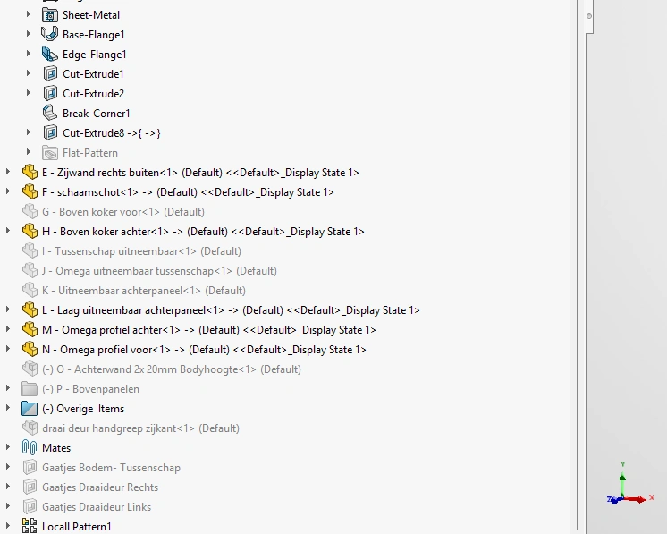

Hi,
I've run into a problem that the assembly features behave different in Assembly than in Part. As shown below "Cut-Extrude 8" is unsuppressed, but the 3 Assembly Features at the bottom (starting with "gaatjes"). This is an issue because we 'scroll' through different configurations of the assembly and once unsuppressed in the assembly they remain unsuppressed in the part even other configurations.
Another problem is that after a hard full rebuild (ctrl-shift-Q) all features (holes) show up instead all being suppressed.
This problem is because of propagate feature to part, but this is necessary because the files will be laser cut and otherwise the features won't show up in the laser file, so turning this off is not an option.
Does anybody know how to manage this properly?
Thanks

I think that you will need to open the part up and create a configuration of the part without the holes and suppress the feature that was added from the assembly cut that added the holes.  Then in the assembly you will be able to pick the one with out the holes.
     The nice thing about moving holes to the parts from an assembly cut is that you only have to modify one feature to update multiple parts, but it can be a pain when you want to not show those holes for some reason, also to make changes to the part the assembly needs to open.  Not a bad thing for simple assemblies that do not take long to open, but larger assemblies that take longer to open it can become time consuming.
