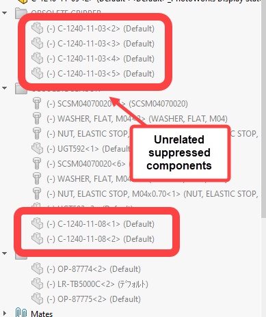

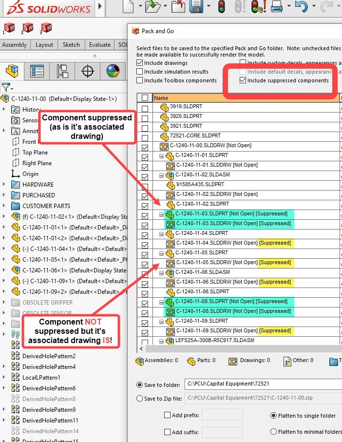

I have a situation where I'm attempting to do a Pack & Go of a small assembly.  When I look at the PnG selection screen, it identifies several DRAWINGS as being suppressed but the associated part models are NOT.

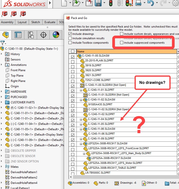

When I uncheck the "Include suppressed components" box, the drawings disappear from the selection list the associated components remain.

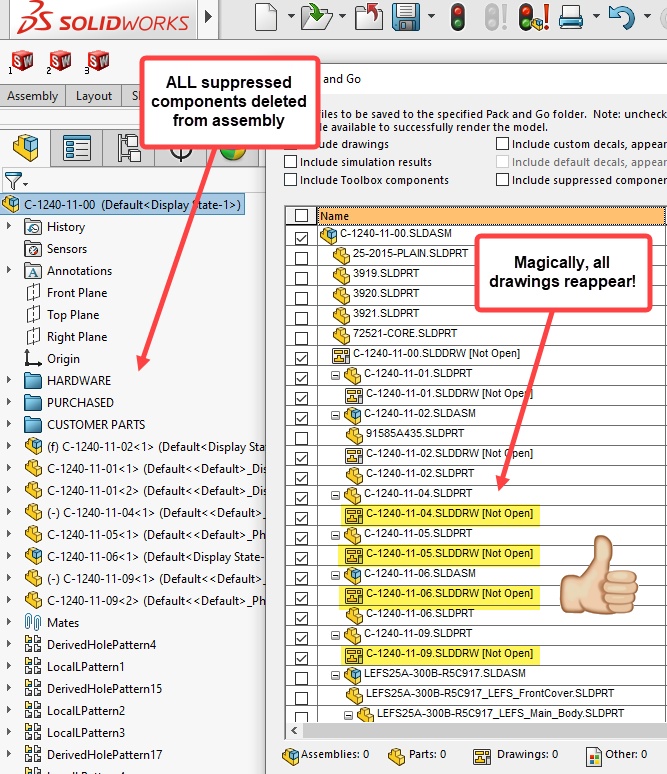

Only after deleting the unrelated suppressed part files from within the assembly, do the previously "suppressed" drawing sheets reappear in the list.
