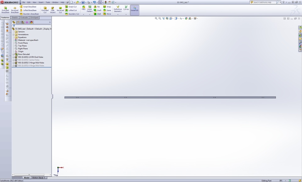

I have a shaft whose length is defined by a global variable called "length". I have holes on the shaft at different places
Case:1....... when the length of the shaft is 50 inches or less there should only be two holes on each end of the shaft.
Case;2.........when the lenght of the shaft is 50 to 70 inches there should be 2 holes on each side and 2 holes in the center.
case:3..........when the length of the shaft is 70 to 90 there should be holes on each end of the shaft and two holes on the 1/3 part and 2 holes on the 2/3rd part.(attachment is a picture of this)
Basically i want some method where i can put a range to the length to unsuppress or suppress a feature(in this case holes). I tried using if statement but it never took me anywhere. anyone to solve this little problem...

here is the part attached in the post about which i was talking about,I have set up a global variable "length" assigned to the Length of the shaft and I have inserted all the holes into place and confined those holes to the equations. Now
Condition 1: I want to show the "RH/LH end holes" at all times no matter what is the length of the shaft.(simple one no need to do any thing about it)
Condition 2: I want to show the "Center holes" only when the length of the shaft is more than 50 inches and less than, equals to 70 inches( I tried if statement and when i put the equations.......... If ("length">50,"unsuppress", "suppress") and if (length<=70,"unsupress","suppress").....it only considers the later condition and not the first condition.
Condition3: I want to show the "4 Hinge mid holes" only when the length of the shaft is more than 70 inches and less than, equals to 90 inches.(I tried if statement again and getting thge same problem as above)
Condition4: I want to show the "5 Hinge mid holes" only when the length of the shaft is more than 90 inches and less than, equals to 110 inches(I get this to working because i dont care about the holes if they show up when the length is above 110 inches because we only have shafts below 110 inches". I used one if statement (if("length">90,"unsuppress","suppress"))).

  Try this file and here are the equations:
Paul
comment imagecomment image

BTW i could not find this "iif" statement anywhere in the documentation or any tutorials or not even in the classes. Can you tell me where have you found this, i mean i am asking this so that in future i can add that to my search area.
Thanks
PM
PM 2012-11-09
John,
  Well, to be honest it shouldn't have to be iif, it should just be if... but SPR 620043 says that nested if's are broken... so knowing that VBA is available you can use iif (based on prior knowledge of stuff like this as well as this thread: https://forum.solidworks.com/message/301290#301290, and the one it references here: https://forum.solidworks.com/message/301201#301201)

Thanks Paul,
I am a starter in VBA and I only knew about the "if" statement and not about the "iif" but now i know. thanks to you.
also Solidworks does not take in the AND/OR equations and Neither it Works with nested "if" (It works with nested "iif"), that is why i was having hard time. But finally the thing matters that you got me out of it. Thanks for all the explanation and your time.
