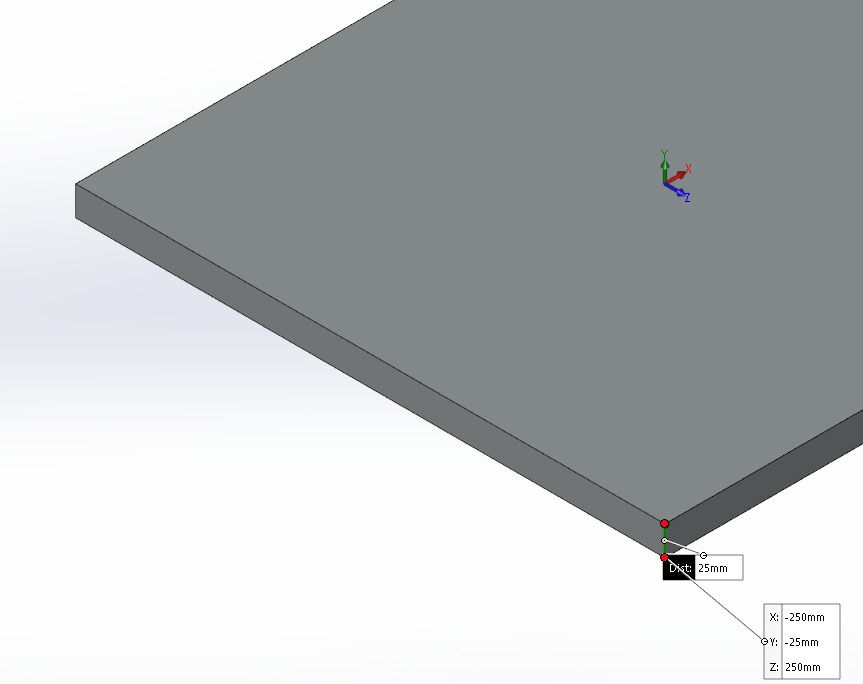

Say for a 25mm plate:

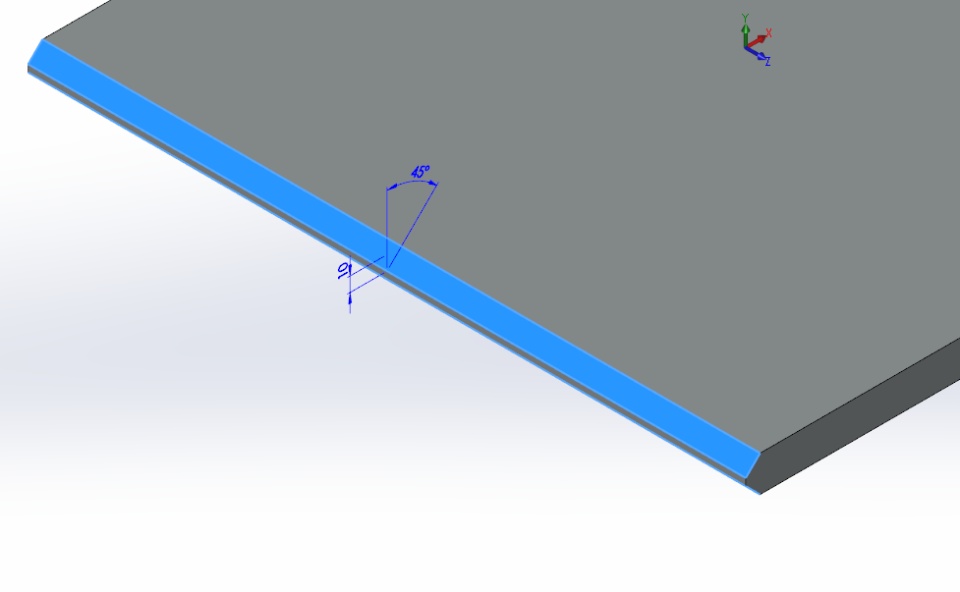

We need to add edge chamfers on this part to butt weld it to another 25mm part. These chamfers are physically added after we have purchased the profiled part.

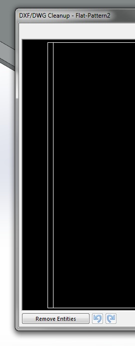

The issue i have is that when these parts are saved to DXF automatically by our PDM system - the chamfer lines are exported as well.
I am looking for a way to ensure that the DXF export is only the outline of the part and any edge features are excluded. We still need holes, bend lines etc to be exported and i am happy we have this mapped correctly with the mapping tool.
The only fix i can see is to create a configuration where these features are suppressed and then manually save the DXF from this, but when creating thousands of parts per year it is a lot of time lost. It also doesn't work well with our PDM which will automatically update DXF files for sheet metal parts every time the part is saved, and no designer is given the DXF/DWG cleanup window.

GH 2021-04-09 Best Answer
Sorry to say, but configurations are the way to go with this.  We do this method all the time with great success.  If you have two configurations (as lasered & as machined) you should have no issue with DXF's creating with each save.  I would suggest changing that process though if you are using EPDM. We create the DXF's during the "Release" state change, letting the designers save often in "work in progress" state without publishing.
