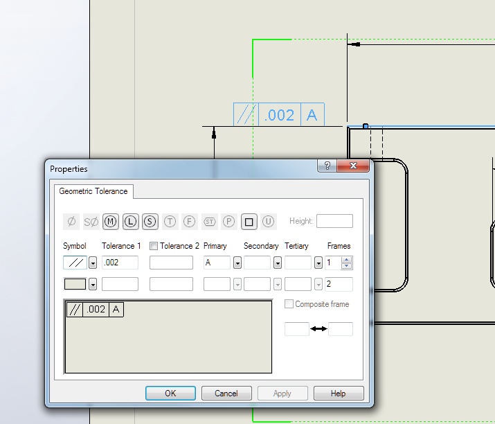

Take a look at the image below.  The top geometric tolerance can be properly placed where I want (sitting above the dimension leader line) without issue.

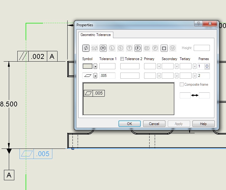

If I want to place another tolerance box BELOW the bottom leader line for the bottom of my part:
I must first enter some dummy data into the top line of the dialog, then put what I really want into the lower line (once it becomes un-greyed).  Then, finally, removing the dummy data from the top line.  I can then place this where I want it, so it sits below the edge I've attached it to.
I'd like a simpler way to do this - a flip control, or grip (like we have for leader lines) that will allow you to invert it.
This has bugged me since I started using SW - finally got unlazy and decided to comment on it.

In case you need something like picture 2, then why don't you add two separate tolerance blocks and position them as required.

I can't position the bottom one where it's at without having to first make entering dummy information in the first row of tolerance info, then filling out the 2nd row, and finally clearing out the top row.  It won't let you position a top row of tolerance block BELOW the edge you've attached it to (without showing an actual leader line if you drag it far enough away).

Are you selecting the model edge or the dimension extention line?
You should be selecting the model edge.
SF
SF 2012-05-09
Ahh that works if you attach it to the dimension line, but not if you attach it to the actual edge of the part (in that case, if I eliminate the leader, the box just floats in space, it doesn't snap to the part edge).  I'll have to remember that - I am in the habit of usually attaching it to the part itself, since I often place the dimension on the opposite end of a part to keep clutter down.

It works fine placing the box above the edge you've selected, but you can't align the box BELOW the edge.  As I said, the only way to accomplish this currently is by utilizing the bottom row of the geo tol properties entry.
