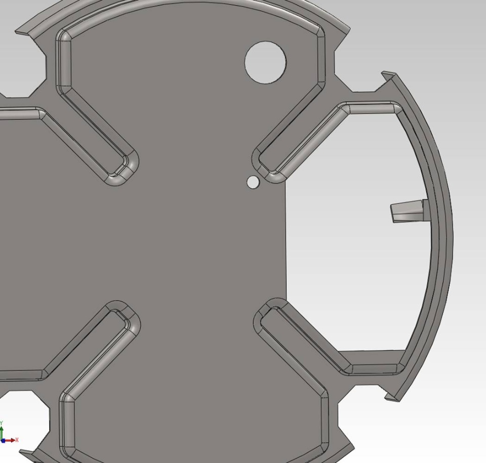

I'm trying to create a pattern of vent features in a cutout  The vent feature consists of a loft and is connected to the edge of the cutout with an extrusion.   I was wondering what type of pattern I should use.   I have tried curve driven pattern but it failes due to the extrusion not always merging to the rest of the part when it follows the curve.  Any thoughts or suggested directions?
BTW the vent is not complete yet in the picture it will have an additional extrusion in the middle to connect the lofts.

I haven't really used fill pattern before.   It appears to be setup for cutouts?

Sorry, I completely misinterpreted what you were trying to do. (Reading what you actually wrote helped)
Can you show a more complete model or sketch of what you are trying to do.
I usually find it easier and better to model the part the way it will be created in a real world machine or metal shop.
i.e. In this case (I think) removing material and forming what's left, rather than removing material and then adding it back in.

The Vents are aligned vertically in the cutouts shown.   See the one complete vent going across on each side.  There are quite a few of them and wanted to pattern or copy the vent into the many positions it will have instead of copying sketches and making many lofts.

It was right in front of me the whole time.   Sketch driven pattern worked great.
