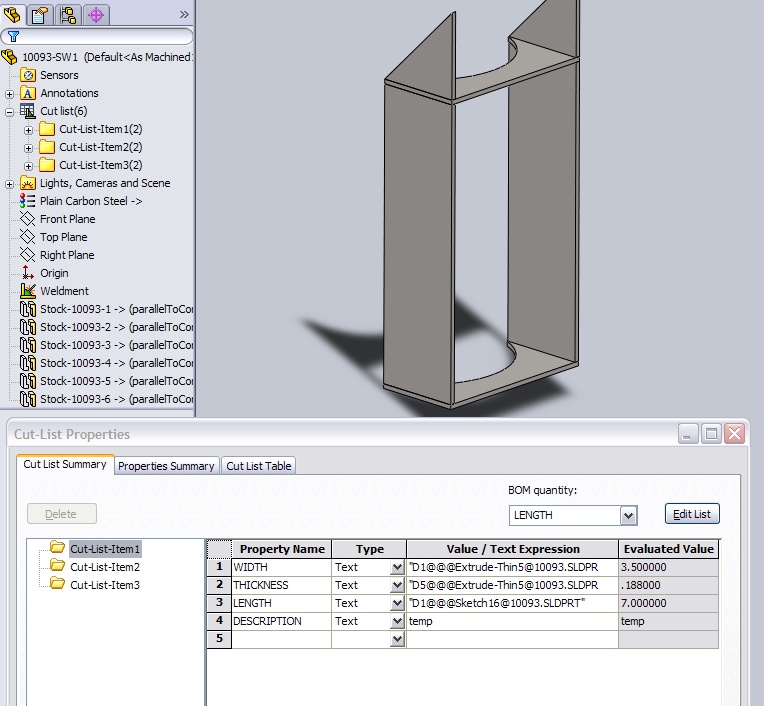

Has anyone encountered the following bug in subweldment cutlists?  I've not created complex weldments before so this is a learning exercise as well.

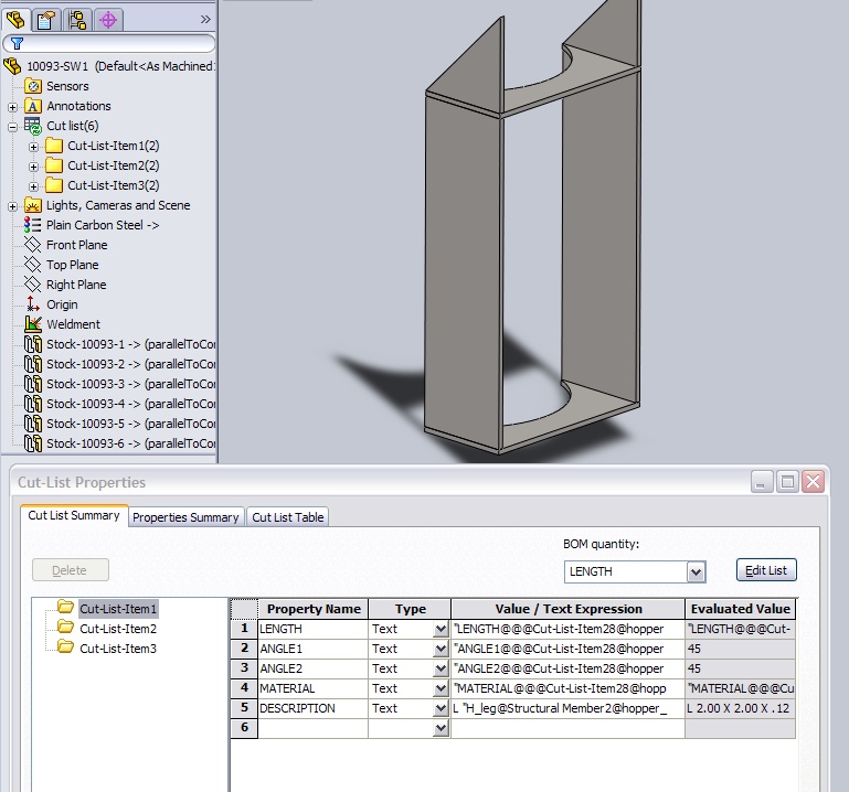

I have a primary weldment for which I have created a subweldment to simplify the part.  When updating the primary weldment with subweldment models open, the subweldment cutlist properties are modified with data from an unrelated cutlist component (angle iron) from the primary weldment.  The revised properties also seem to be permanent, as I cannot delete them afterwards.
Running SP5.0 so is there a fix for this?  Pics attached.

Try temporarily chaning the property name to something else (I usually just add an X on the end of the name).  See if the value stays after doing this.  You can then change the name back after exiting the properties screen and coming back into it.
If this works then I believe you are experiencing the problems reported in the SPR listed below.
SPR 544464 "Cannot override material manually in cutlist properties."
The workaround is to change the MATERIAL property's name to something else, then modify its value. Then change the property's name back to MATERIAL.

Your suggestion corrects issues with deleting the properties, thanks.  However, the main issue that SW completely removes and replaces existing subweldment cutlist properties with unrelated data when the primary model is open makes this a temporary fix only.
Also, I have since realized that linking to dimensions within the primary weldment is not a good idea for several reasons.
  1. If I load the subweldment only, the properties cannot be evaluated.
  2. If I load the subweldment with the primary weldment open, SW nags me that it wants to rebuild.
  3. If I need to update props info in the cutlist, the file references are automagically updated by SW to the active part for all properties when selecting a different cut list item.
  4. Even if I disassociate cutlist description and length columns to user-defined, SW will reassociate the columns after changes to the primary weldment.  This may have been due to the Automatic setting in the cutlists.
In the case of #3 & #4, I love it when software tries so hard to be smart it's dumb.  Looks like I'll just have to hard code data.  I don't have time to learn by trial and error.

I often get this poblem with inserted parts.
SPR 585537 may address this problem. It was supposed to have been addressed in 2008.
