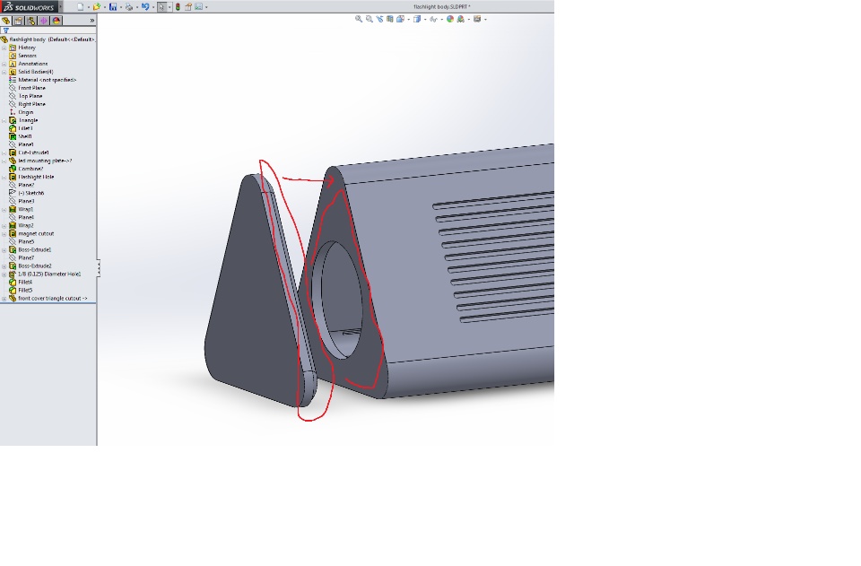

Hi, I'm trying to get this chamfer to become indented into the face of my main body. When I do the subtract combine, the preview shows what I want but the final output doesn't do anything. Any help would be much appreciated!

They don't appear to be intersecting to me?
Did you move it back simply for illustration, or is it a new function in 2014 to Combine-Subtract non-intersecting solid bodies?

Yeah I just moved it backwards so you guys can see what kind of shape I was trying to get at.

You can see that the chamfer from the first piece is indented into the triangle face of the main body. Honestly, I just don't think I'm using the right method to do this. Is there anyway to get a chamfer that goes inwards?

I think you'll find that your part is carrying out the Combine feature correctly. The problem is your front cover triangle part is very thin walled & barely shows any difference. If you do a section on the Right plane after the Combine & zoom right in, you can see the subtraction.
