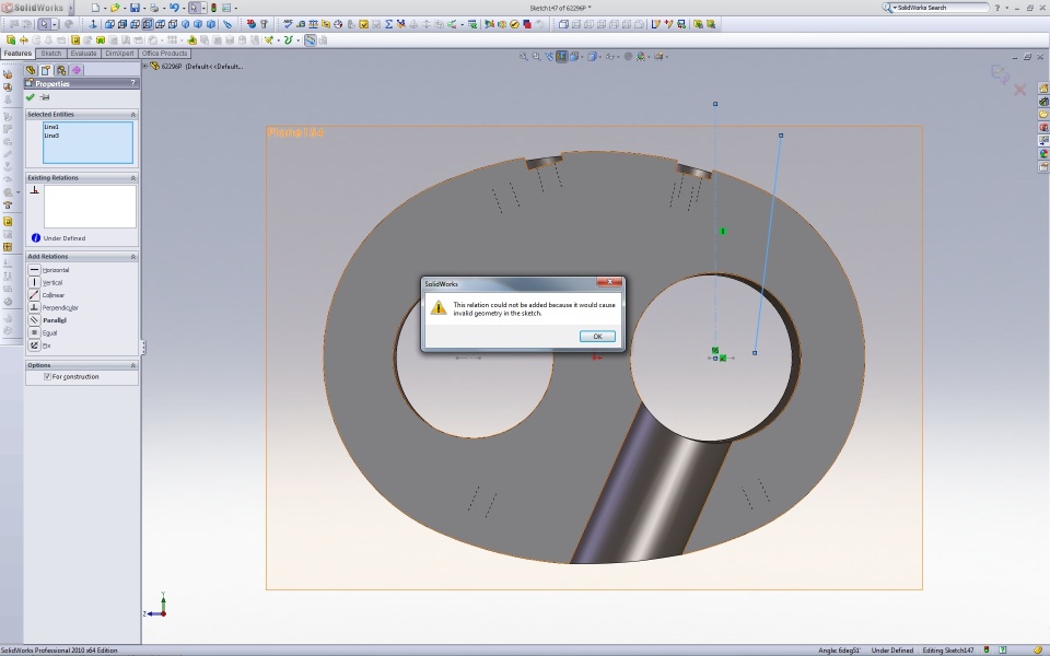

I have been using SW for almost 10 years and this just bugs the crap out of me. When I draw a line and want to add a line either next to it or maybe later and add a relation to it like maybe parallel, I get this stupid error "This relation could not be added because it would cause invalid geometry in the sketch" WTF???? All I want to do is add a line & have a relation to another line. Anyone that can help me, pleeeeez do!!

there are no dims yet. It's just two lines period. Herer is a pic with the stupid error. The only way to get these parallel is to mouse over the construction line the move over & draw the new line.

I think I have an idea about what's going on here. This scenario appears to the eye that it should easily solve with the new relation. The problem is that the sketch solver can't see. After the parallel relation is added, the solver attempts to move geometry so that all conditions are satisfied. The solver considers the lines to be infinite and the end points are points coincident to the line. The construction line has a couple additional relations which will prevent its movement. As you have not added any dimensions, at least three of the points are free to move anywhere along the newly solved line. For example, the points may become coincident and create a zero length line. A zero length line is invalid and would cause you many downstream issues. I've seen the near parallel case fail more frequently in the 3D sketch, but it is possible in 2D as well. I expect you will get much better behavior if you add a couple dimensions or relations between the endpoints before making the lines parallel.

As a workaround for instantly adding a parallel relation as you draw.
Let's say the lines are not drawn yet.
1. Draw the construction line
2. Select the construction line
3. If you start drawing the second line - first click - (with the construction line selected at step 2) you will see the yellow inference lines, allowing you to draw the second line as perpendicular or parallel to the first one
4. The relation will be added automatically.

AV 2010-11-12
Sorry, I do not understand. Are you sure you tried my suggestion before rushing to say it sucks?
Once the line is selected (the orange one in the picture below) and you start drawing the second line, there are only 2 inference lines, which would create a parallel relation, respective a perpendicular relation to the selected line.
Try it for yourself.

I am reverse engineering this particular part, so some of the lines are not fully defined. I have attached the model. Have fun...........
This is part of a Bassoon from the 1960's (Boot Joint)

I am having a similar issue.  I have had problems adding relations and get the error that you describe, "This relation could not be added because it would cause invalid geometry in the sketch."  It has occurred for equal length and collinear.  It doesn't occur consistently, sometimes I can draw two new lines and set them equal, sometimes I can't.  One notable detail is that I have the units set to feet & inches, and I can't get the error to occur in anything but feet and inches.  I have seen a few other people post issues on this problem and I highly doubt they have this unit selected.  I am also baffled why this would matter.  I have been playing around with it trying to find where the issue lies and have come up empty.
I have the most up to date version of Solidworks 2010.  I have used Solidworks for years and never remember fighting this hard with sketch relations.  I love Solidworks because they are so flexible/powerful.  Why can't I set two lines equal length (sometimes)?  But when it happens, trying again doesn't help, it continues to happen 100%.  Though, I left the sketch, re-entered and added the relation and it worked.  I have also changed the units to mm and had it work.  Doesn't SW used mm or something native internally and just convert the numbers it shows you?
Edit: I got the error in mm and inch as well.  It happens often when editing a sketch in the context of the assembly, and sometimes works if I open up the part alone and add the relation.  I'll try and get a simple part where the error is repeatable and post it.
