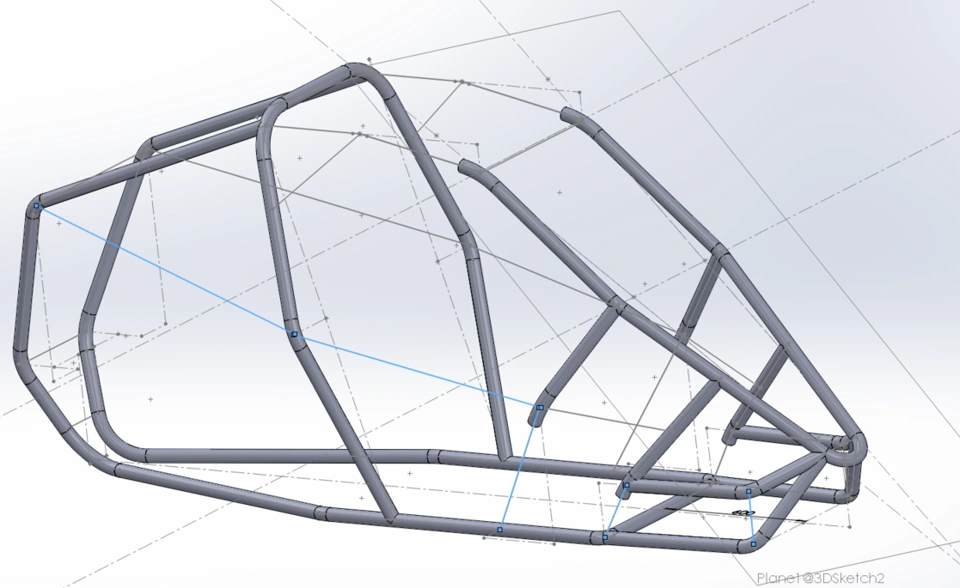

I am trying to draw a body for a buggy but am running into not being able to create structure members from the lines I drew. I have 2 major problems:
  1. some lines just straight up do not let me make them into structure members
  2. I cant get a line on the top part of the buggy to not just go thrue another pipe that is already drawn
the gighlithed lines are the ones I can't turn into structure members
the line taht I cant shorten to make it just tuch the pipe. cuting the line didn't work, seperating it didnt work, making a point on it didn't work (I have no more ideas)

You're splitting the lines across 3 separate 3D sketches. As such, there are disjointed intersections.
I can add another member and then trim each end in their own trim operation. I did add a plane on the bent end for trimming.
I will suggest you leverage symmetry as much as possible using mirror instead of adding members on both sides.
comment imagecomment imagecomment imagecomment image
KC
KC 2026-10-05
Another path, although it may involve having to redo your existing members, but if you roll to below your last 3D sketch, start a new 3D sketch and Convert Entities on all of the required lines/arcs from your (3) existing 3D sketches, keeping in mind the use of symmetry.
Use this 3D sketch, that contains all lines/arcs, to build your members.
