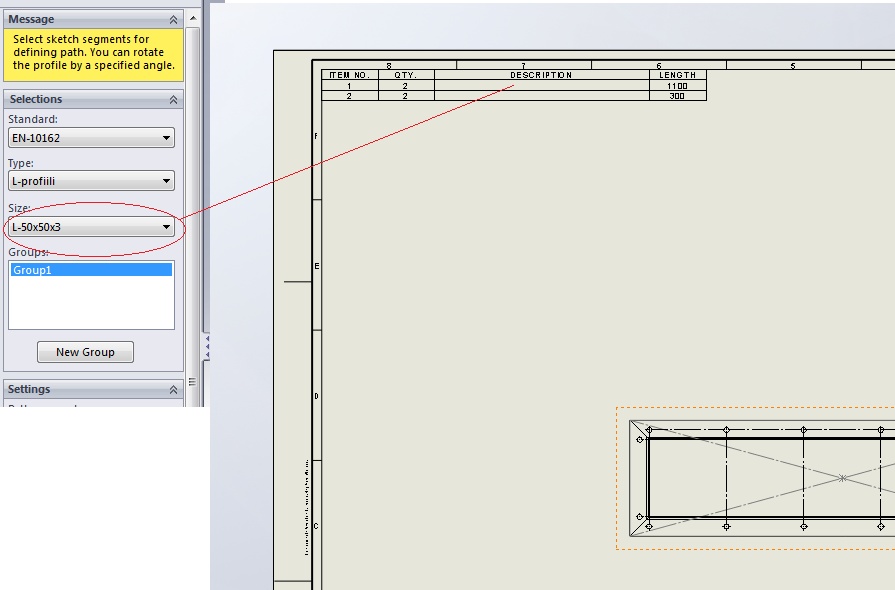

I have tried to but structural member size/profile to weldment cut list description with no luck. Is there any other way to do it then write it to the Custom properties ---> description?
I hope that picture will tell what I'm trying to do.

Olli,
First make sure your cutlist in the model is updated.
Regards,
               john
SF
SF 2012-04-23
Cutlist in model have been updated.
JM
JM 2012-04-23
Olli,

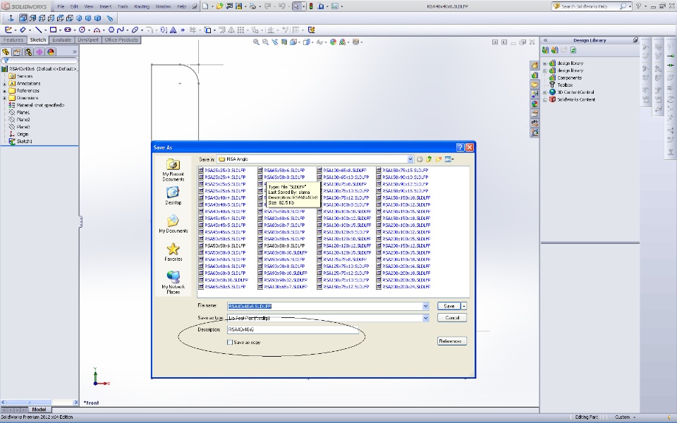

weldment cutlist description is taken from the description set in the profiles file. Check these have been filled in. See attached
Regards,
               john.

If this description wasn't filled in for all structural members used. Can it be done afterwards without a lot of work?
JM
JM 2012-04-25
Tom,
I cannot find a quick way of doing this. You will have to edit each file in solidworks or edit the file properties in windows explorer. As this thread has been answered it may be beneficial to start a new open thread to make others aware of your problem.

As SW doesn't update the structural members when the profile is updated, I added all the descriptions in my part for this assembly myself. Was a bit of work, but less than having to update the profiles manually.
Good thing is that you can add the description in windows explorer. Now everything will be ok next time.
