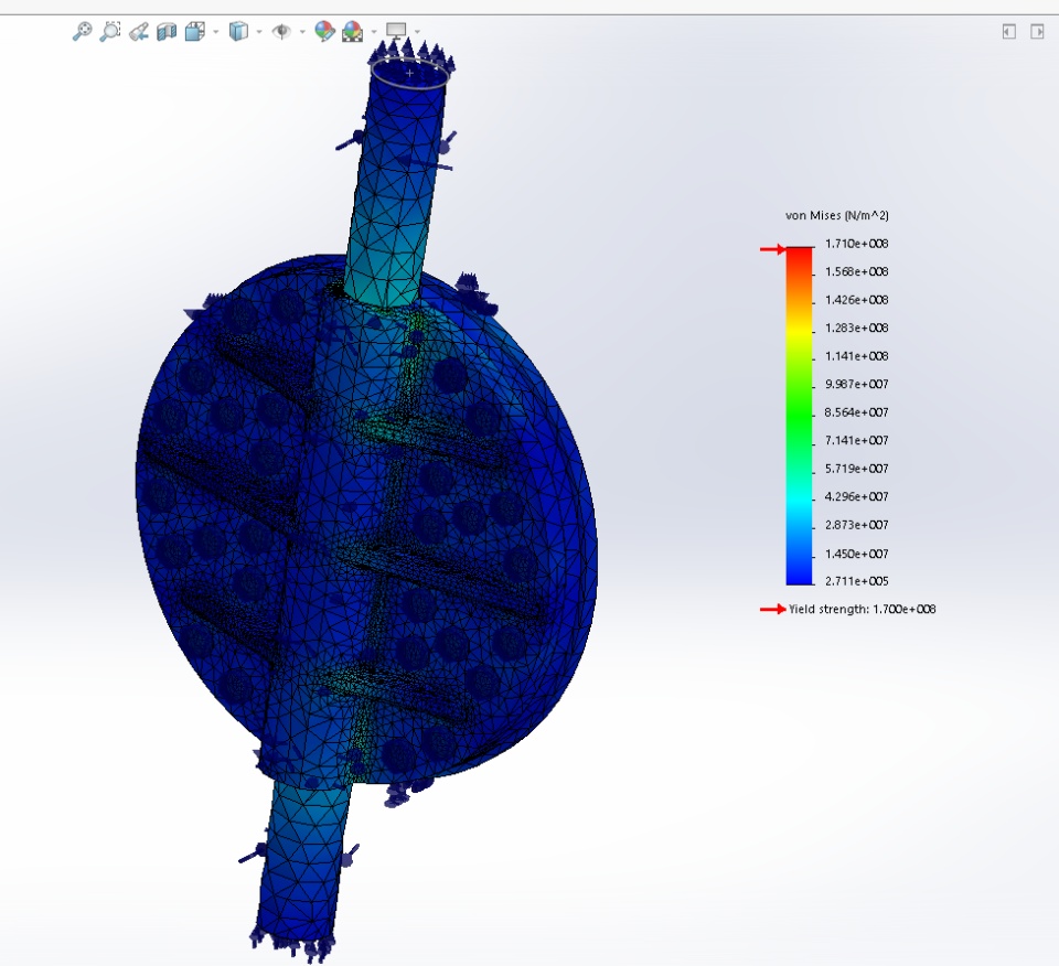

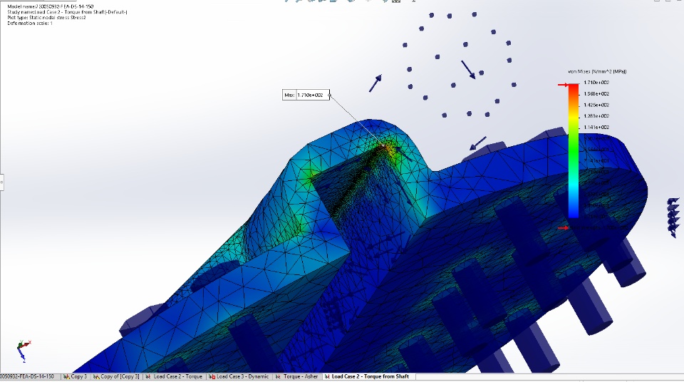

I hope someone can help me on this, I am currently analysing a valve system, one of the studies that I am conducting is a applied torque from the shaft of the disc (mainly testing to see if the ribs are suitable). However i am getting a stress figure that is very close to yield (205 Mpa) I have applied a mesh control to the high stress area but my i'm not confident in the result as the concentration is right on an edge (there is a shaft that fits in the slot ),
What would generally be the approach that someone would take to this?
Regards
Ryan

Hi Ryan, it appears from the figure that this is not a singularity, as long as there is a fillet on that edge. The mesh does not look fine enough to me for this high stress gradient. I think a finer mesh control is needed on the fillet, and also perhaps on the other two edges emananating from the fillet. To make sure you get the right answer requires refining the mesh control until the answer no longer changes.
An alternative is to use adaptive analysis. If you've never done that, right-click on the analysis, choose properties, then the adaptive tab, then click h-adaptive, and hit ok. I don't recommend p-adaptive, the implementation in SOLIDWORKS is not that robust (in my experience).
I gave a detailed talk on getting accurate stresses at SOLIDWORKS World 2017, it's on my website www.stressrefine.com
