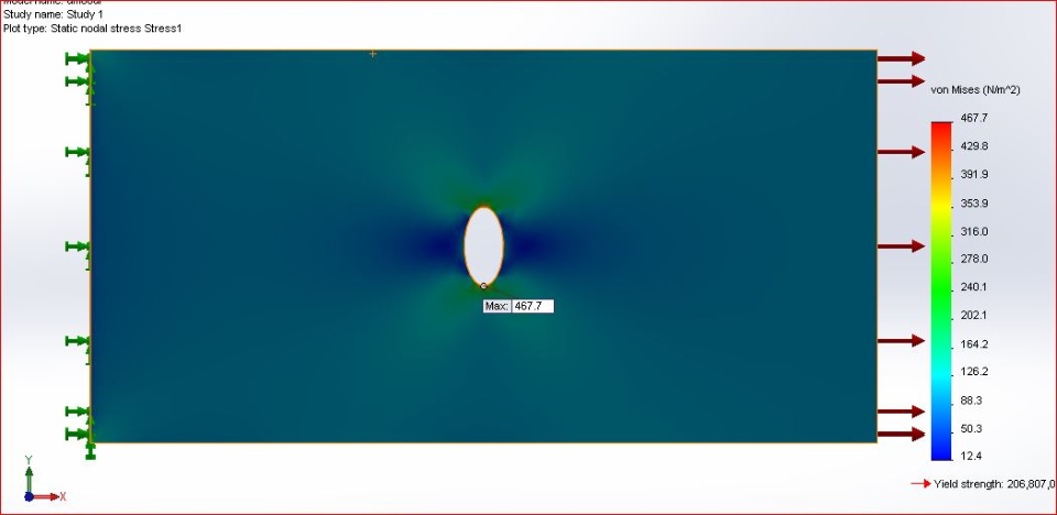

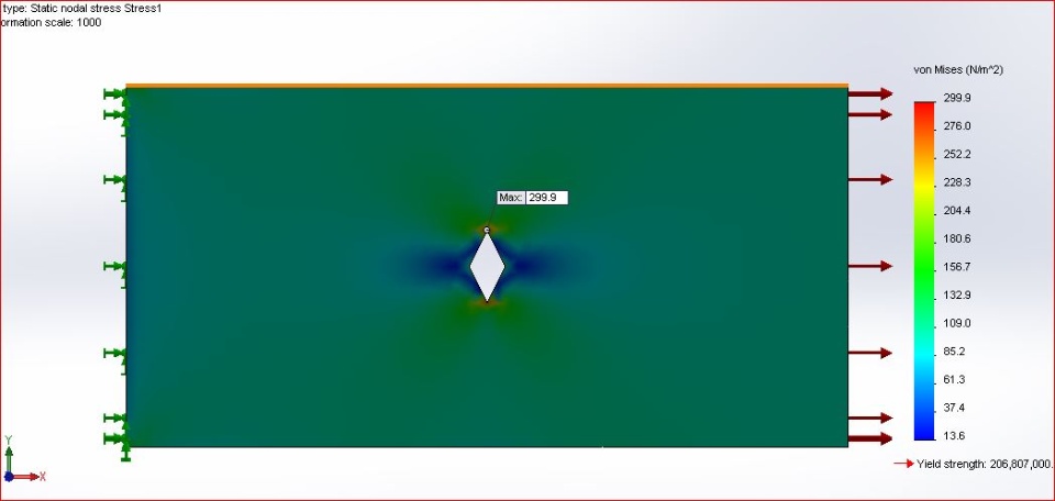

stress concentration problem!
please help me to solve this problem.
Plate:100*200*4
Pressur:100kpa
Material:AISI304
why stress concentration factor in oval is higher than diamond؟
it is irrational!
Stress concentration factor for this oval with 100kpa pressur is K=4.5
but for this diamond with higher notch sensitivity,stress concentration is K=2.9
SolidworksSimulation
